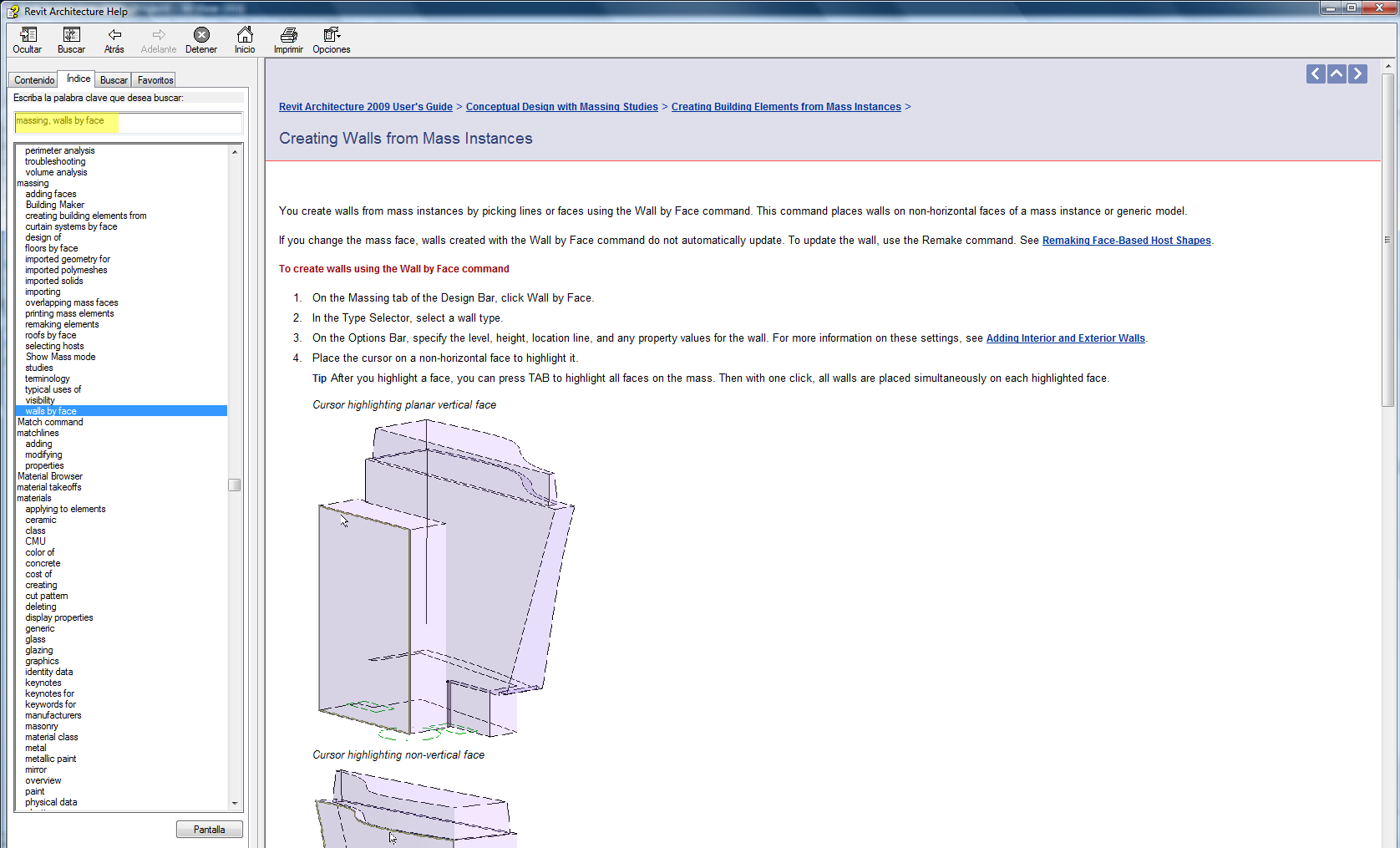

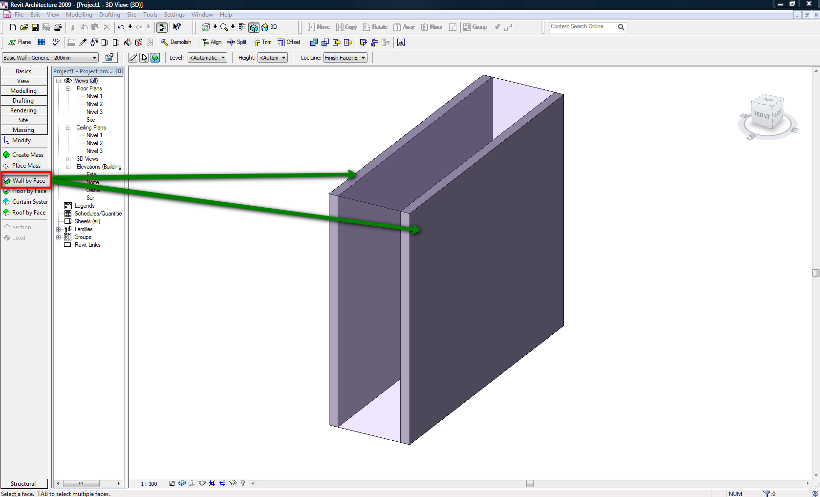

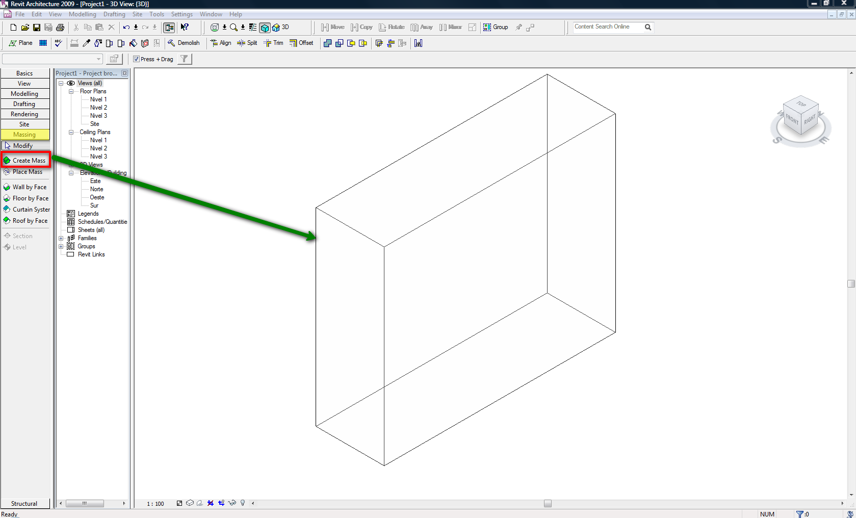

Hi...Did you read your HELP Menu:"Massing: Walls by face"?...see images for a better reference....
