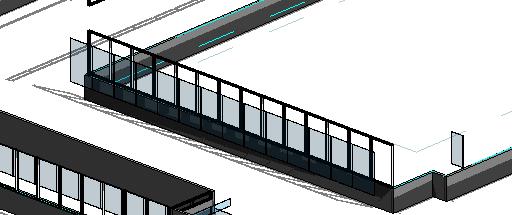

 I'm just trying to use a curtain wall with glass panels sandwiched between two other walls.
The glass panels however are separated from the mullions. Why is this?

Looks like you may have two curtain walls...

also you may want to check the glass panel family and make sure it is correctyl set to center in the curtain wall.
