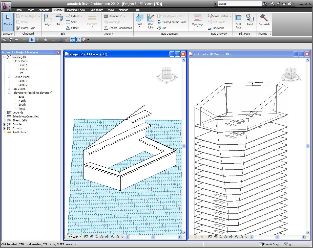

I have a sloped wall in elevation, and i'm trying to add a sloped coping .  i have the profile but when i add it to the sloped wall it only goes horizontal. how do i slope it?  ive tried to add it to the wall profile itself as well as using the Wall/Wall Sweep command, and neither will work
Thanks!!
(the attached image is an example of both the ways ive tried. its not the finished product, i was just trying to get this to work)
 Cryingversion 2010)

ill give it a try, and im sorry i thought it was attached. ill try again.
the image on the right is my building. the one on the left was the two ways i tried to do it.
thanks for your help!

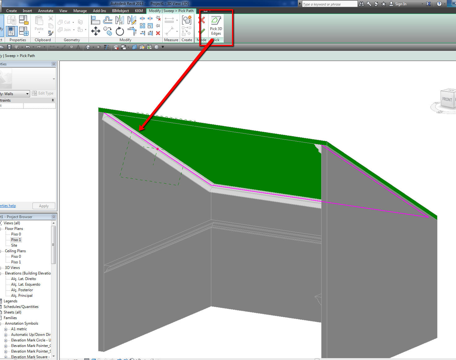

Hi,
I have a similar question, but for the interiors.
I created a room with a sloped ceiling and edited the wall with sweep for cornice. However, after attaching the walls to the ceiling, the sweep stayed at 8 ft, which does not make sense since the shortes wall is still higher than that. The sweep is set to be -3" from the top of the wall. Do you know how to make the cornice sweep follow the sloped wall as well as the different height walls?

Same process, Model in-place > Sweep > pick 3D Edges
