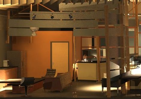

I am suffering the same problem with a different modeled in place.
I have a wall that is basically bare studs wrapped on one side with strips of translucent plastic (image attached)
I am now trying to figure out the area of plastic.. how many 4x8 sheets will be required.
In order to ensure the panels are aligned I used a solid blend (the main arc actually is a cone shape, narrowing towards the ceiling).
Any advice?  Even how to re-build it in a schedule-able method? Maybe a wall hosted to a solid?
