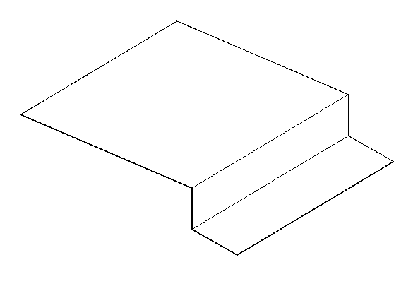

Sorry i dont have a picture im at home not work. but i have a roof at a 1/2" / 12" slope. and i needing to turn that roof down at a 90 angle. after tunging it down 5' i need to start another roof at a 1/2" / 12" slope. i know i could do this using a inplace model, or if i make multiple roofs and joined them.
but down anyone know a way to do this?? if you need a picture let me know and ill post one in the morning.

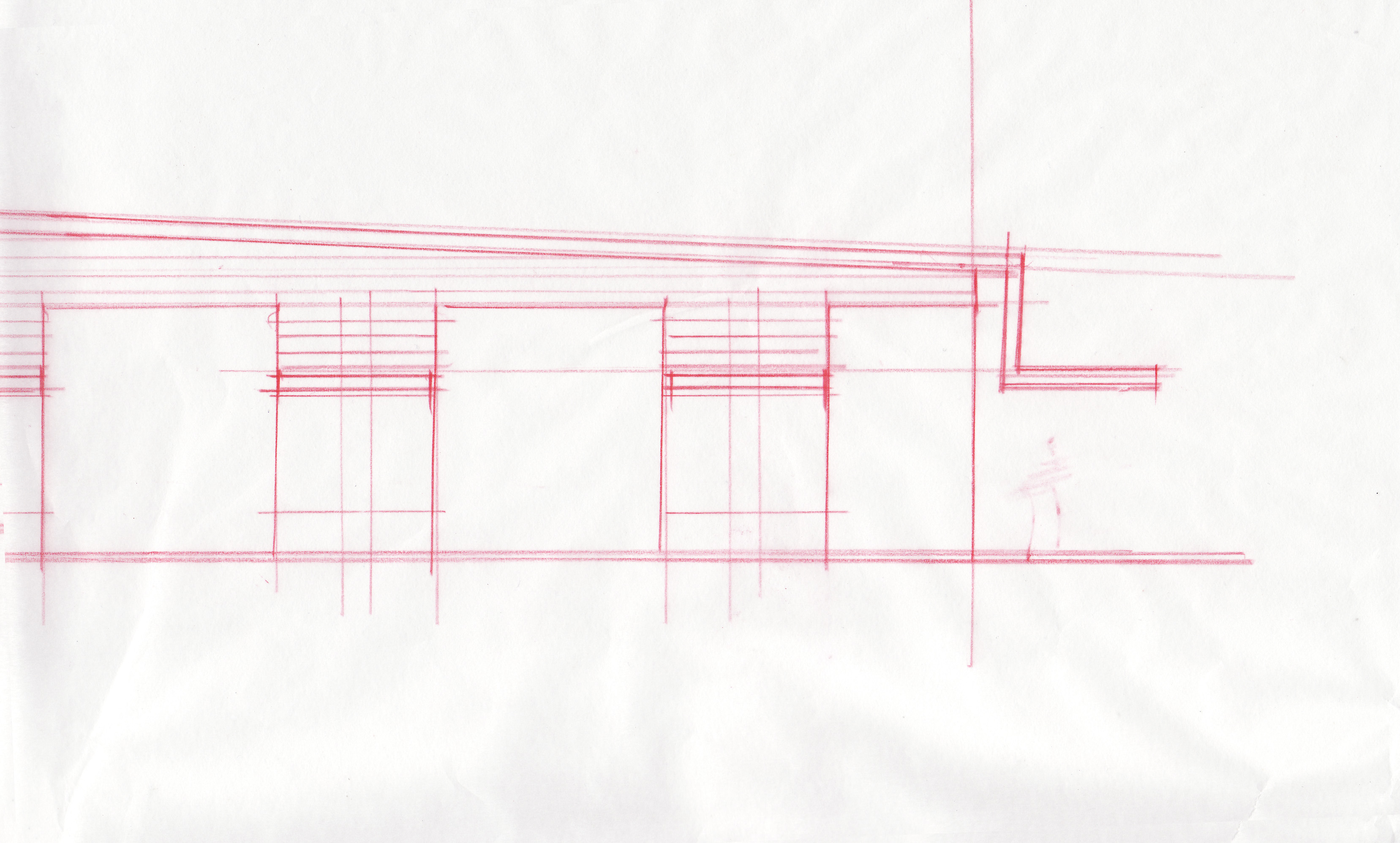

HERE ARE THE PICS OF THAT ROOF TURNING DOWN I WAS WALKING ABOUT.Edited on: Tue, Sep 29, 2009 at 8:38:18 AM

Allen, create that by extrusion...

Allen do it with Roof by Extrusion
