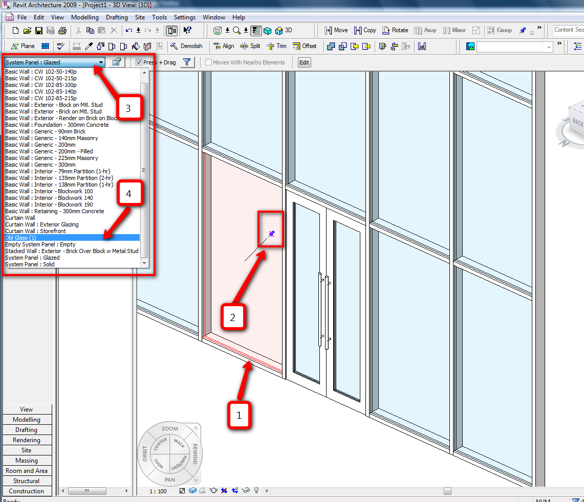

I'm having a problem loading componets. When I go to load my components, either from this website, or the ones preloaded, it never loads them. Like I go through the whole process of loading the components, and it says "regenerating" at the bottom, but nothing happens. For example, I was wanting just a simple storefront curtain wall door put in, and I went to load it from the preloaded doors, and when I do that, it automatically goes back to "single-flush" door at the top. Do I have something turned off to where it won't allow me to place components? Help!

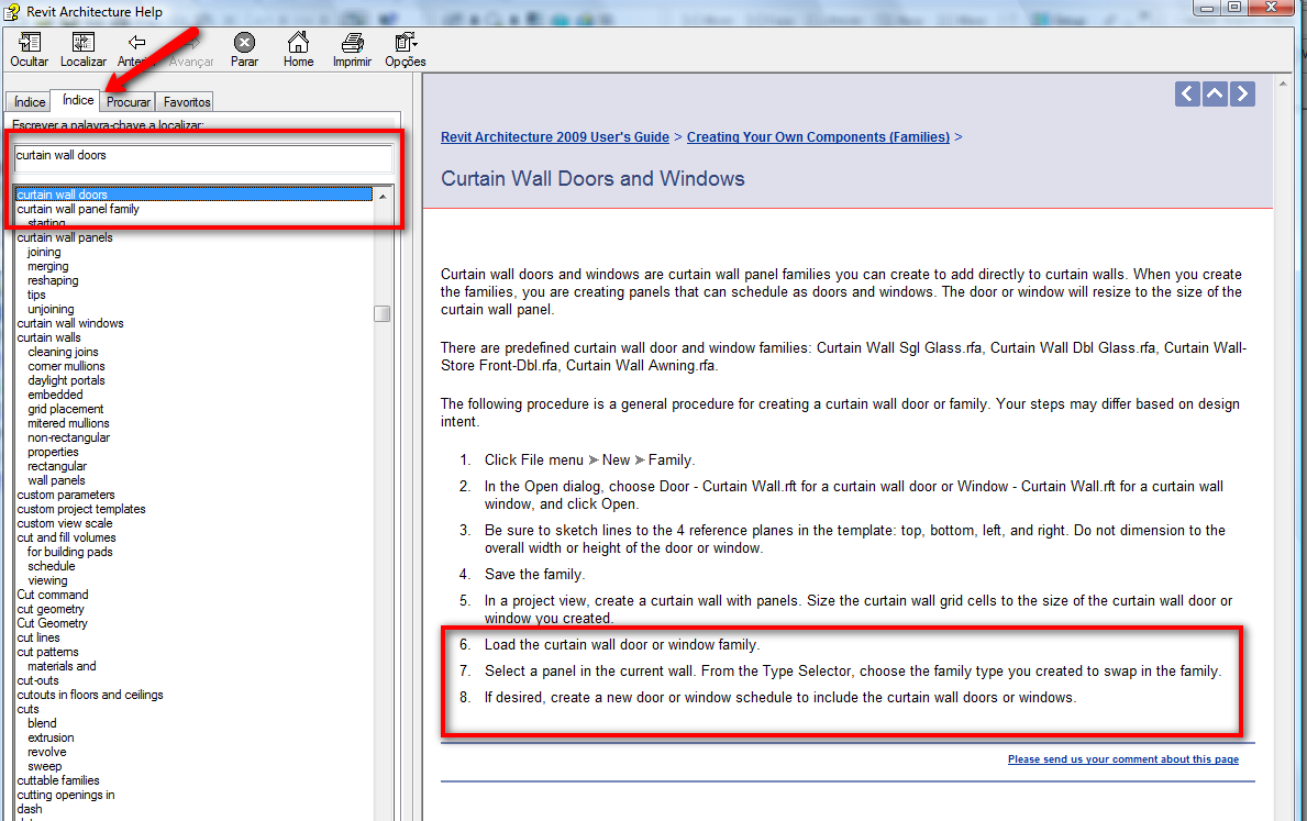

I think you should read first the HELP menu, it's a good "Book"....
1- select the panel
2- Unpin  the panel
3- Go to the type selector in the options bar
4- select the curtain wall door/window you pre-loaded
