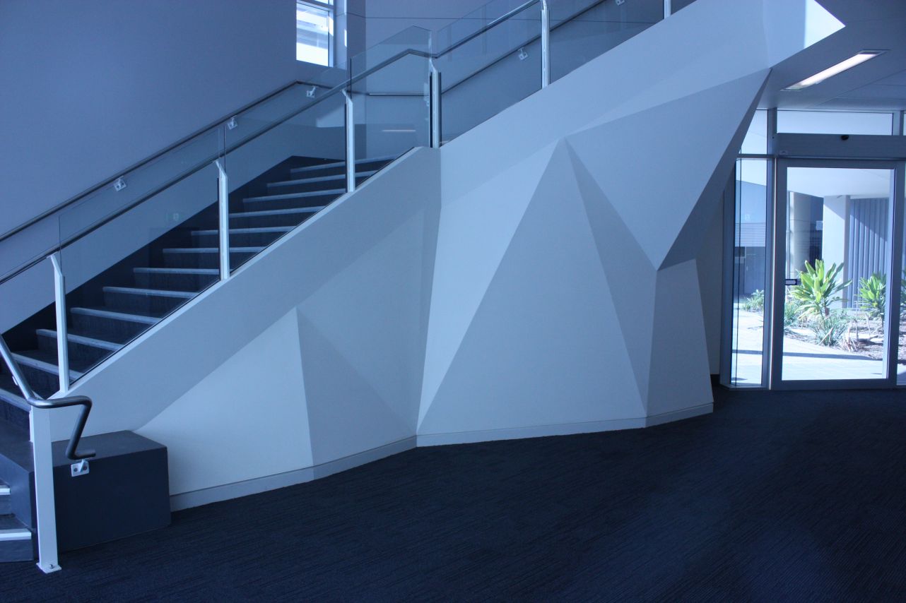

 I want to model up the below picture in Revit. In your opinion, what would be the simplest & most efficiant way of doing this. I initially tried an in-place faimly and cut out the different faces with void extrustions, but this was messy, un-accurate & time-consuming.
Any suggestions would be appreciated.

We can't see in Plan view but, in What version?? Well, i think i use also the "Create-in-place" Extrusions, maybe some Blend.... Only see that in plan and elevations I can decide the best way....

if you new all the exact dimensions, you could draw it in sketchup and load it into a family,  or you could do a conceptual mass. or try typ's idea and use some voids.
Either way you need to work out some dimensions for this first.
