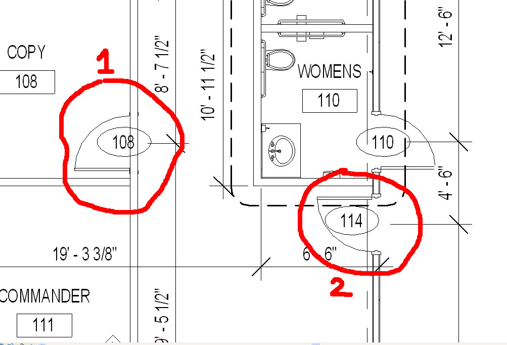

Hello-
I have been working on this floor plan for months and have had no problems with the walls appearing correctly, but Today I noticed that some doors appear (in plan) to not cut openings through the walls.  In section and elevation the doors and walls look perfect.  I have not changed any view parameters settings in several weeks.  Another weird thing is that these "weird" walls also do not show the line of the gypsum board.
I have attached a JPEG which illustrates how two walls which are of the same family, with two doors also in the same family appear different in the same plan.
I have no idea how to fix this.  Any/all help is GREATLY appreciated
Thanks!!

Hi,
 Have you tried to change the cut plane to which you view your plan?
It is in view properties, and scroll down to find view range. change it to 2000mm or something.
 GL.

have you checked them out in elevation view? one door might be a different height in elevation or hosted to a different level?
