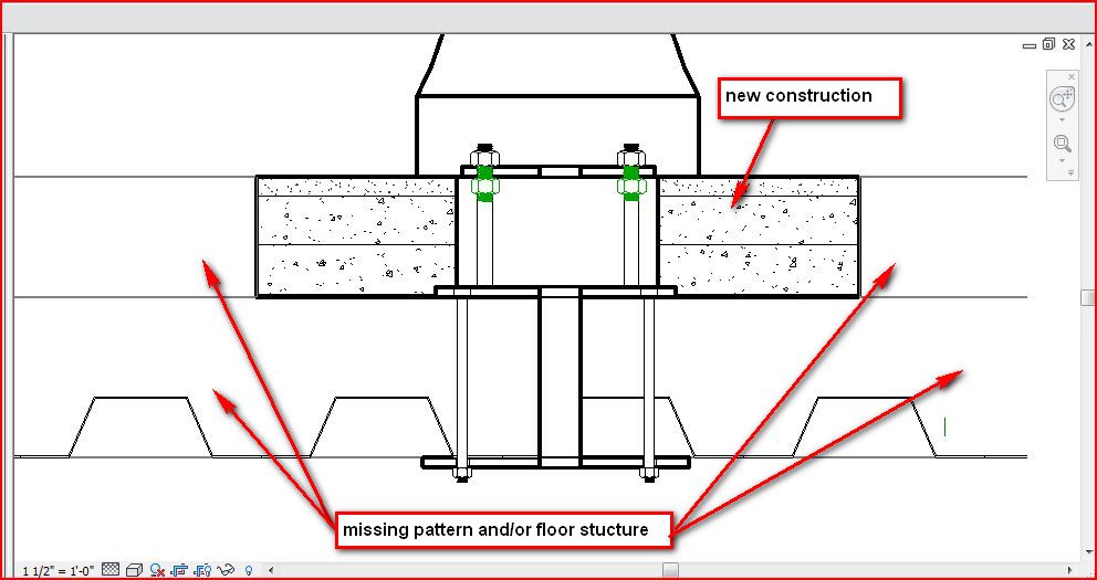

The Intent
I am trying to show a section cut of a floor (please refer to attached image) and a new floor in a new construction view, showing previous and new.  The views INTENT is to show the existing as is sits next to and corresponds to the new construction.  The existing is a simple construction of (from top to bottom): Top half is paver stone, cement bed, concrete fill; Bottom half is simply concrete.  All materials are completely selected and have cut patterns.
The Problem
In this view, neither the cut pattern nor the structure of the existing floor is visible.  I attempted to turn on the visibility override of in the Phase settings, but this did not work for the floor.
I am open for suggestions to solve this visibility issue and/or perform a different method to achieve the same "intent."
THANKS!

Quoting dgcad from 2009-09-18 11:41:18
"Is the section view set to 'fine' detail ?"
yes it is.

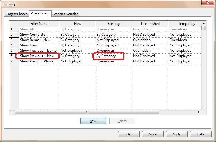

Fri, Sep 18, 2009 at 2:50:07 PM | Trouble with visibilty of existing floor cut pattern and structure
dgcad
dgcad Avatar
Joined: Thu, Mar 17, 2005
1231 Posts
3.5 Stars: 36 Votes
It works for me. See attached images.
All I did was change the Phase Filter 'Show Previous + New' > Existing to > 'By Category'.
It appears that by default this is set as an override to eliminate the cut pattern. In other words they do not expect you to show cut patterns of existing objects when set to 'Show Previous + New'.
Fri, Sep 18, 2009 at 3:25:31 PM | dgcad
qabulin
qabulin Avatar
Joined: Mon, Aug 25, 2008
74 Posts
5 Stars: 1 Votes
Quoting dgcad from 2009-09-18 14:50:07
Ah ha!  If it were a snake, it would have bit me!  Rolling Eyes
Thanks mate!
