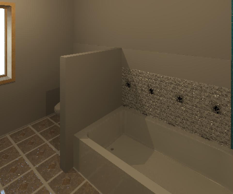

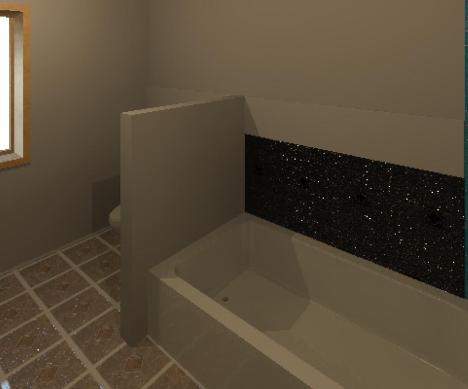

Can anyone tell me why my custom material is rendering black? I have attached both the material file and the file i intended on using as the bump file along with 2 renderings og my model. Its weird if I use the bump file then Revit will render it but not my color jpeg. Please help I have a client review tonight.

got the solution !!! my big brother told me about it! you just open the pic in photoshop >imag>mode> and choose rgb
not cmyk ! dont ask why but it works!
