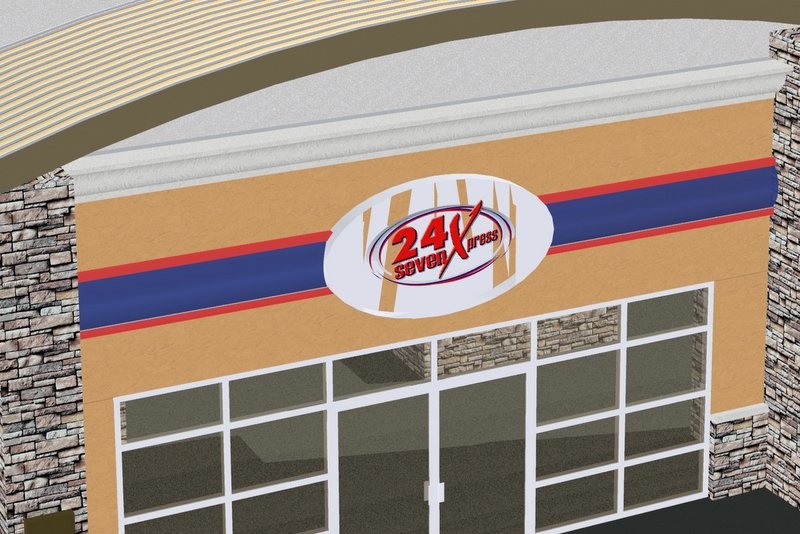

Does anybody know why this might be happening? (see attached jpg) Version 8.0. Decal has a white transparent mask so you can see the object behind through parts of the logo where there is white. Any ideas

Figured it out. I had masked color as transparent also. Unchecking this fixed it.....
