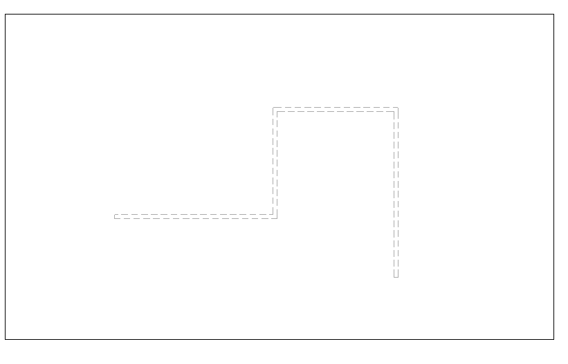

Hi all,
is there a way to give the underlay an override, for example, everything under the floor i would like to have it hiddenline type instead of continues  ?
How to ovveride?

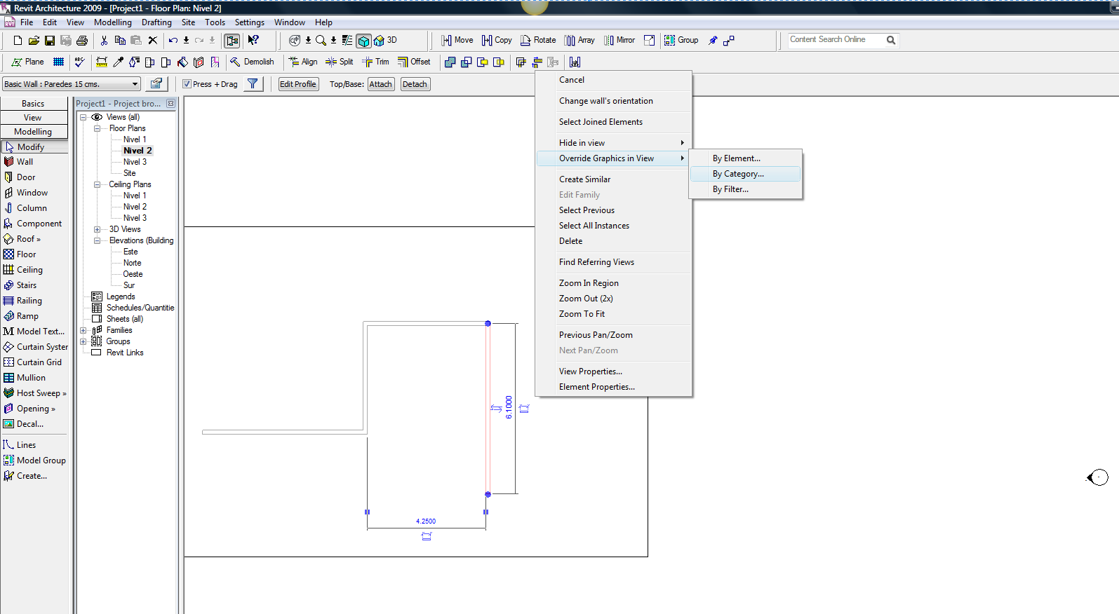

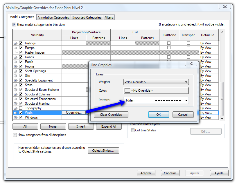

Right click i.e. one of the wall under the floor-->Override Graphics in View-->By Category..., select Walls-->Projection/Surface-->Lines and override the line with the pattern you want....i think qabulin needs a rest....ShinyShinyShiny.....

Qubulin,
 I Need it as an global override and dont want to override by category, but indeed both do work!
