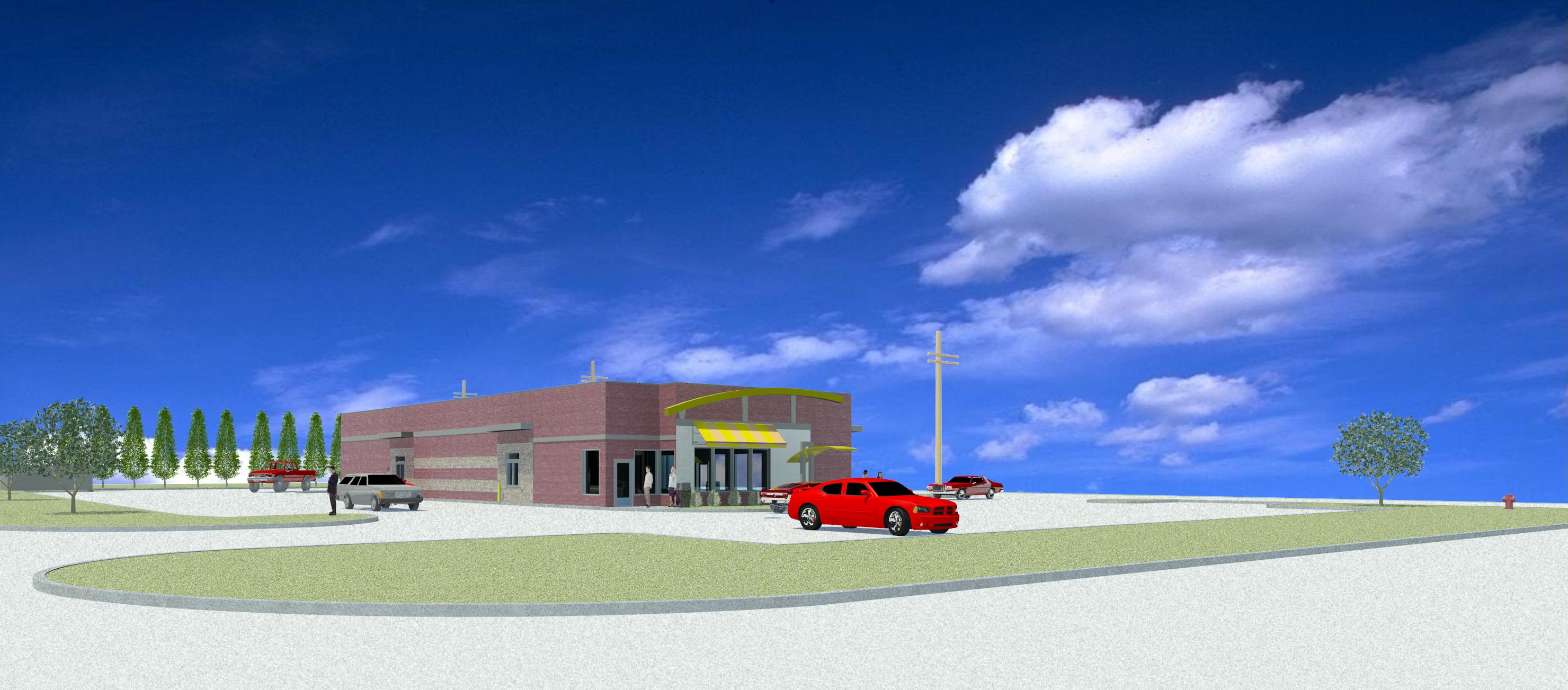

when you click sky. go down to image and load an image in from your computer. like this one. this is in 2012. I have used 2010, but I dont remember if this is an option or not
