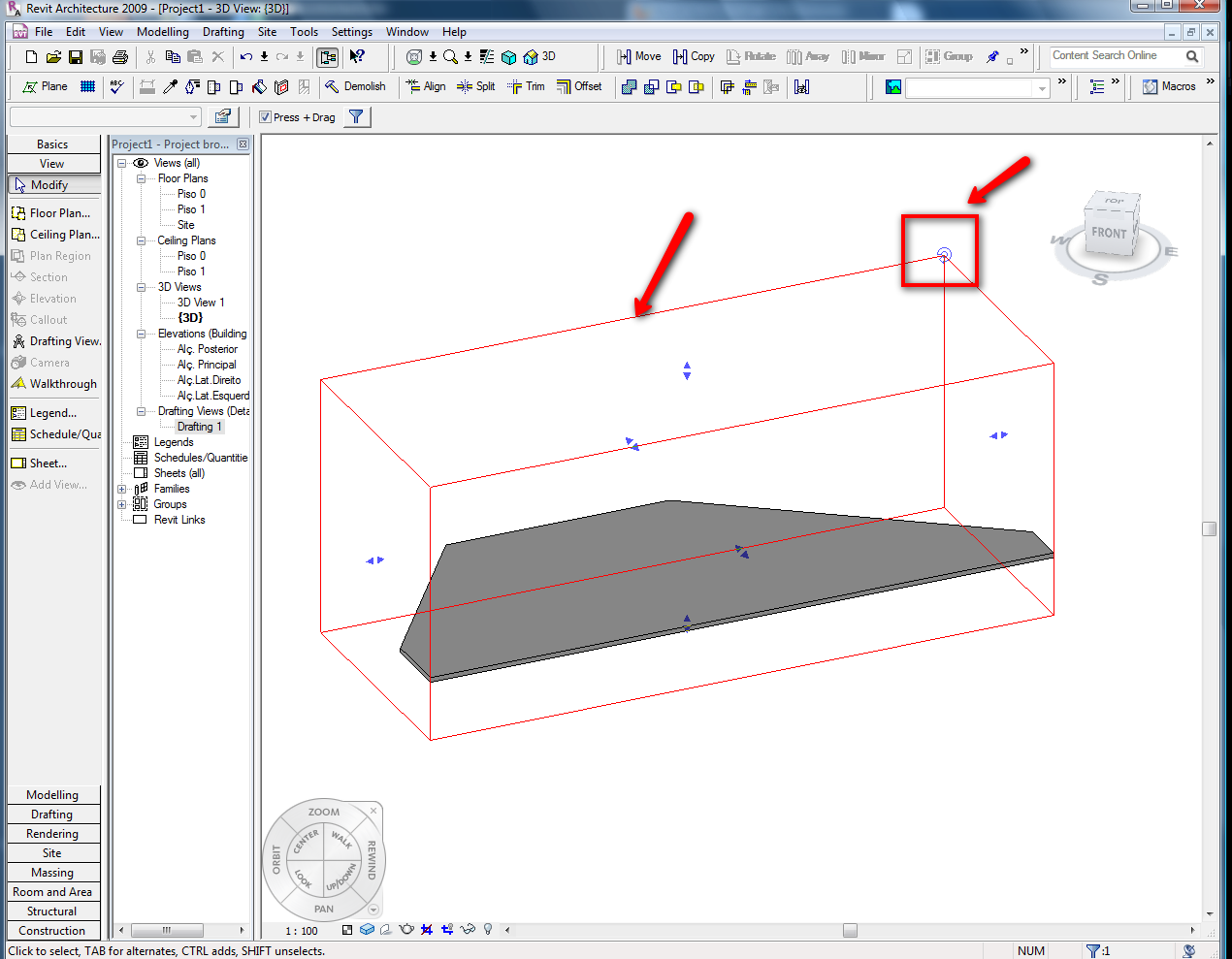

I am using Revit MEP 2010 and I need to take my 3D model and cut it diagonally through the model and at an angle. How do I do that? I have looked in my book and the help page and no advice there.

I don't know if this is what you need but in the 3d view, right click and in the view properties turn on the "Section Box" the pick in the section box and you can rotate and adjust like you want...

Typhoon... that was a good one, didn't know you can do that. Is there a way you can rotate it in a (elevation view) Vertical direction? It's only doing it in plan view. Thanks.

No, but you have the "Blue Arrows" to drag and cut like you  want...
