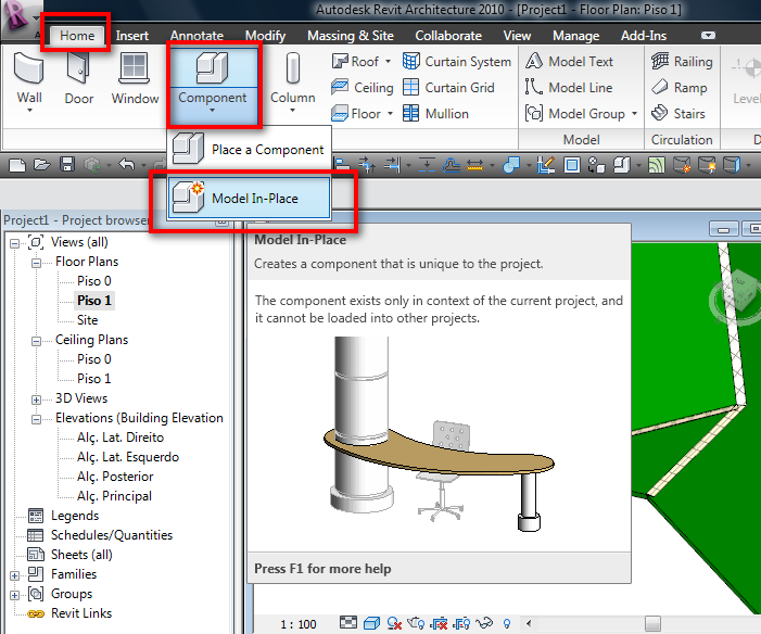

You are not creating a "IN-PLACE", you are in the "MASS" that's why you can't cut, in 2010 the in-place are in HOME>COMPONENT>MODEL IN-PLACE, then you can just choose the category you want "ROOF" and cut the roof like you want...

Ah, okay now I understand. I really hate 2010, it's such a clusterf*ck.
