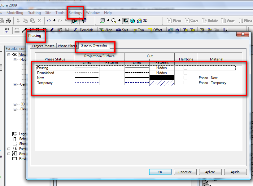

How can I change the line width?
 Ex.: existing walls should be different from new walls and so on........
Thanks..
Mon, Aug 24, 2009 at 2:00:58 PM | line width
Joined: Tue, May 22, 2007
5921 Posts
4 Stars: 205 Votes
Did you try in Settings>Phase>Phasing....
