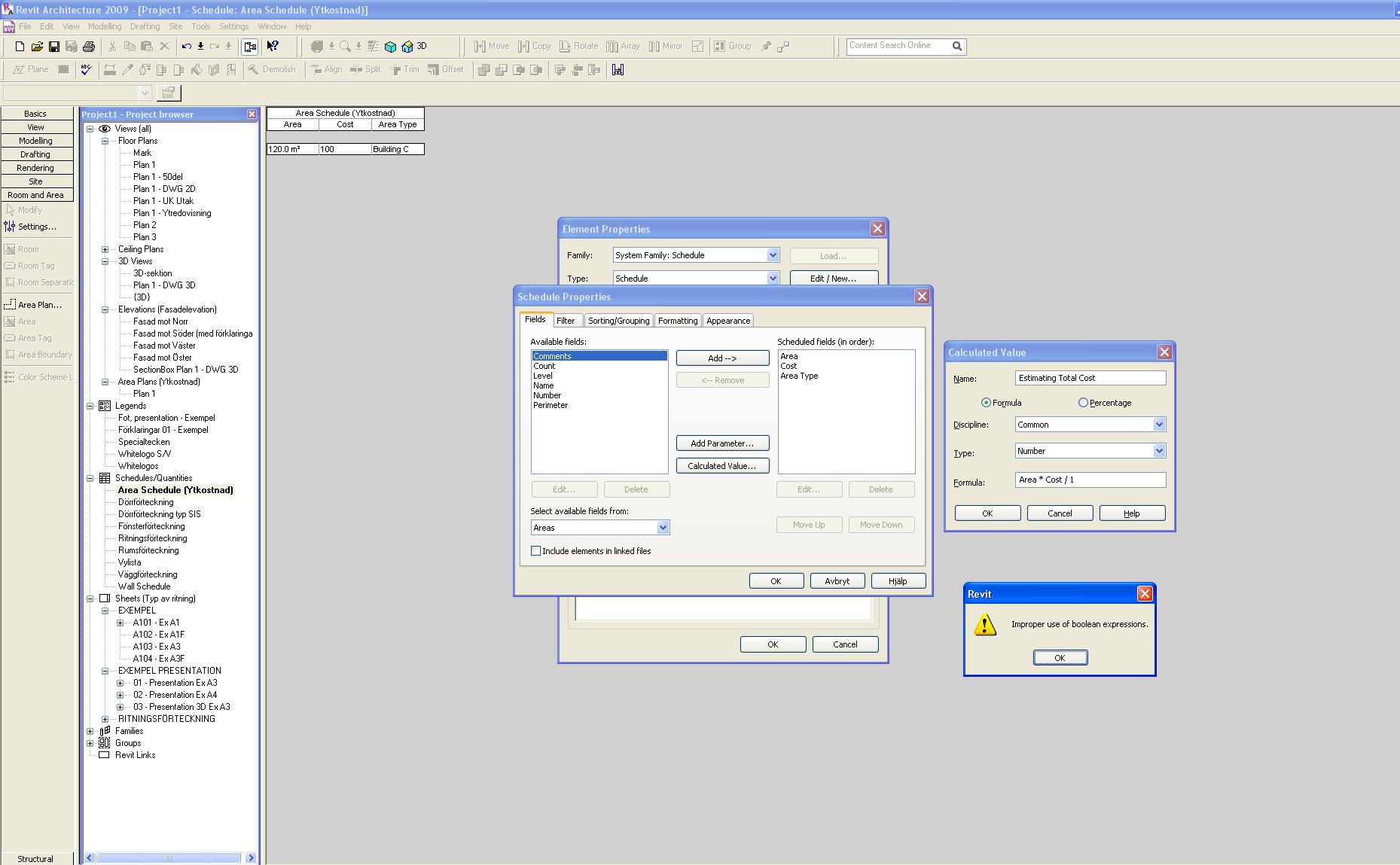

I´ve tried to make an area schedule where i can calculate estimated total cost. I´ve made an area plan and then in the area schedule i´ve added the parameter Cost by myself and also added Area and Area Type. When i make an Calculated value that i call "Estimated Total Cost" with the string "Area * Cost / 1" i only get the asnwer "Improper use of boolean expressions". What am i doing wrong ?

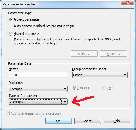

I played around with trying to recreate this error and the only problem I could think of is that your Cost field may not have the correct units (currency).  Check that to make sure it's not "text" or some other incalculable unit.
