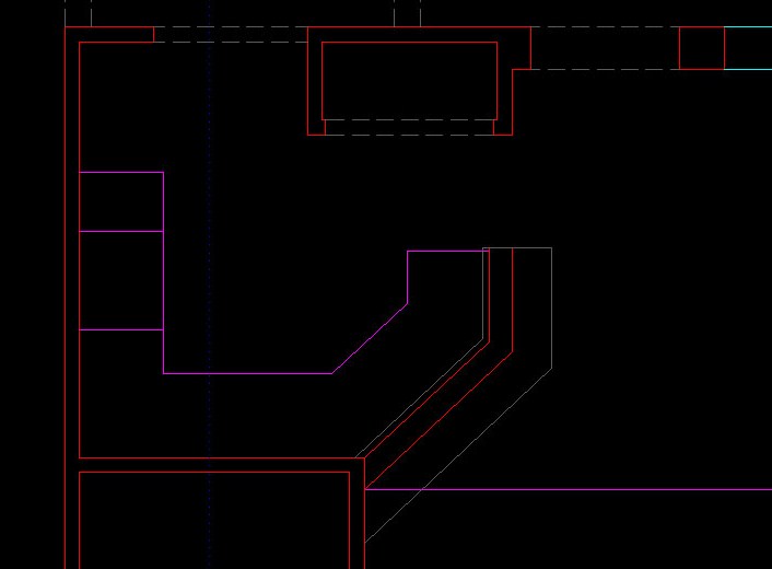

Attached image is the shape of my countertop. Can you please tell me how to make it or join the geometry of the existing counters. I just tried to use L-shape & Single counter top with sink. When I try to arrange them as per my Kitchen shape, it overlaps on eachother. can I join geometry to avoid overlap? I tried that comand but doesn't work.
 Thanks.
Fri, Aug 21, 2009 at 12:46:49 PM | To Create Kitchen counter top & Closet shelf
3.5 Stars: 403 Votes

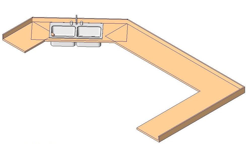

Sorry but this is a special shaped counter.  I would do an in-place family... Simple plan extrusion - category casework ... sketch it in plan - set your extrusion start and end - materials and even sketch the hole for the sink - all done in about 2-5 minutes.
