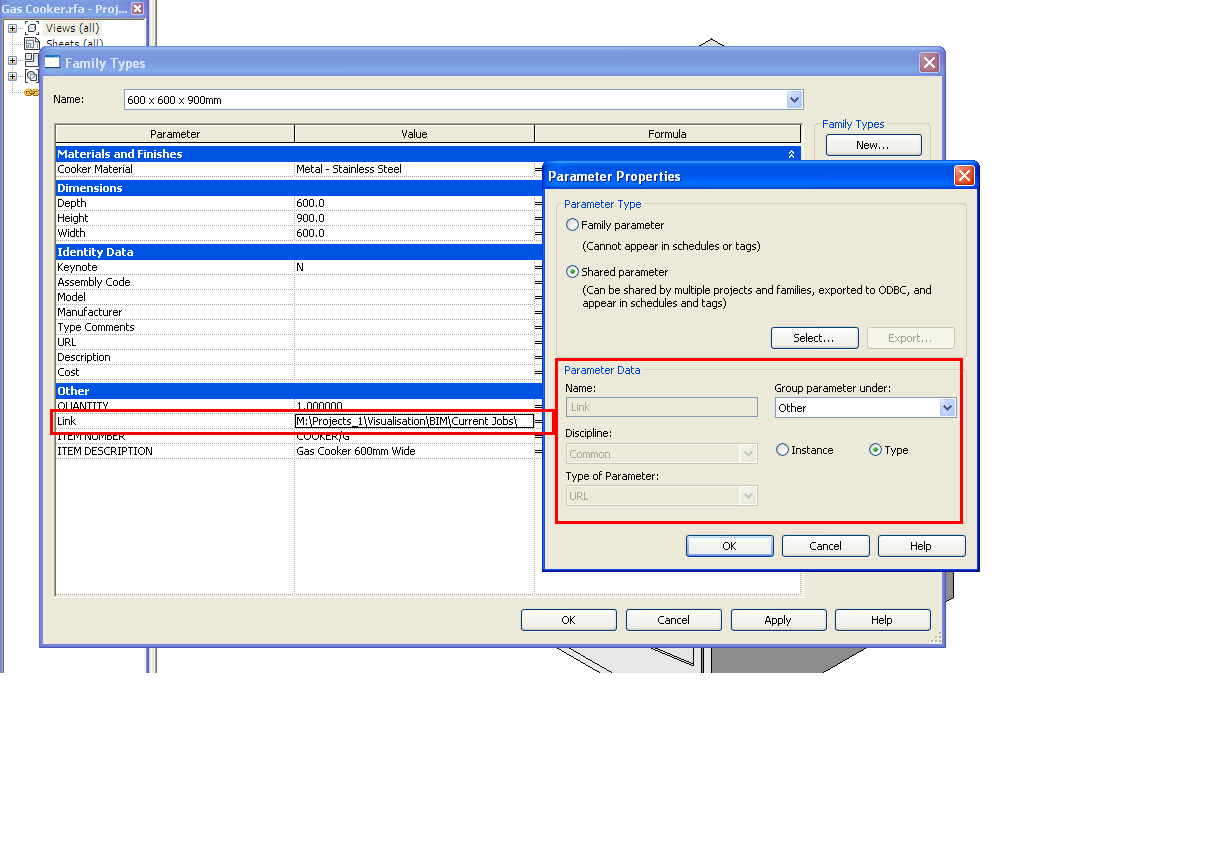

Hub do u mean to say URL parameter. Please see attached snapshot
I think it gives you the location of file. I cannot open the file directly.
let me know if there is something else
Thanks for your help.
Now on the implementation stage....
Thu, Aug 20, 2009 at 7:32:03 AM | It it possible to link PDF with Component?
Rams ... this is one of those screwy things in REVIT.  Place the URL address or even a network address in that URL field.  You are right - clicking on that does nothing except it pops up the little box with the ... on the right - the traditional dropdown box right?  .... think again - click on the box and see what happens! <Big GRIN>
