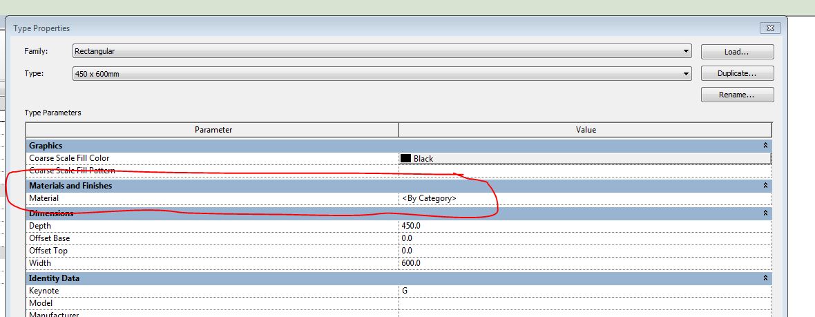

Hey Roxanneharris,
You can use the inbuilt parameter with columns to change the material, see image attached.

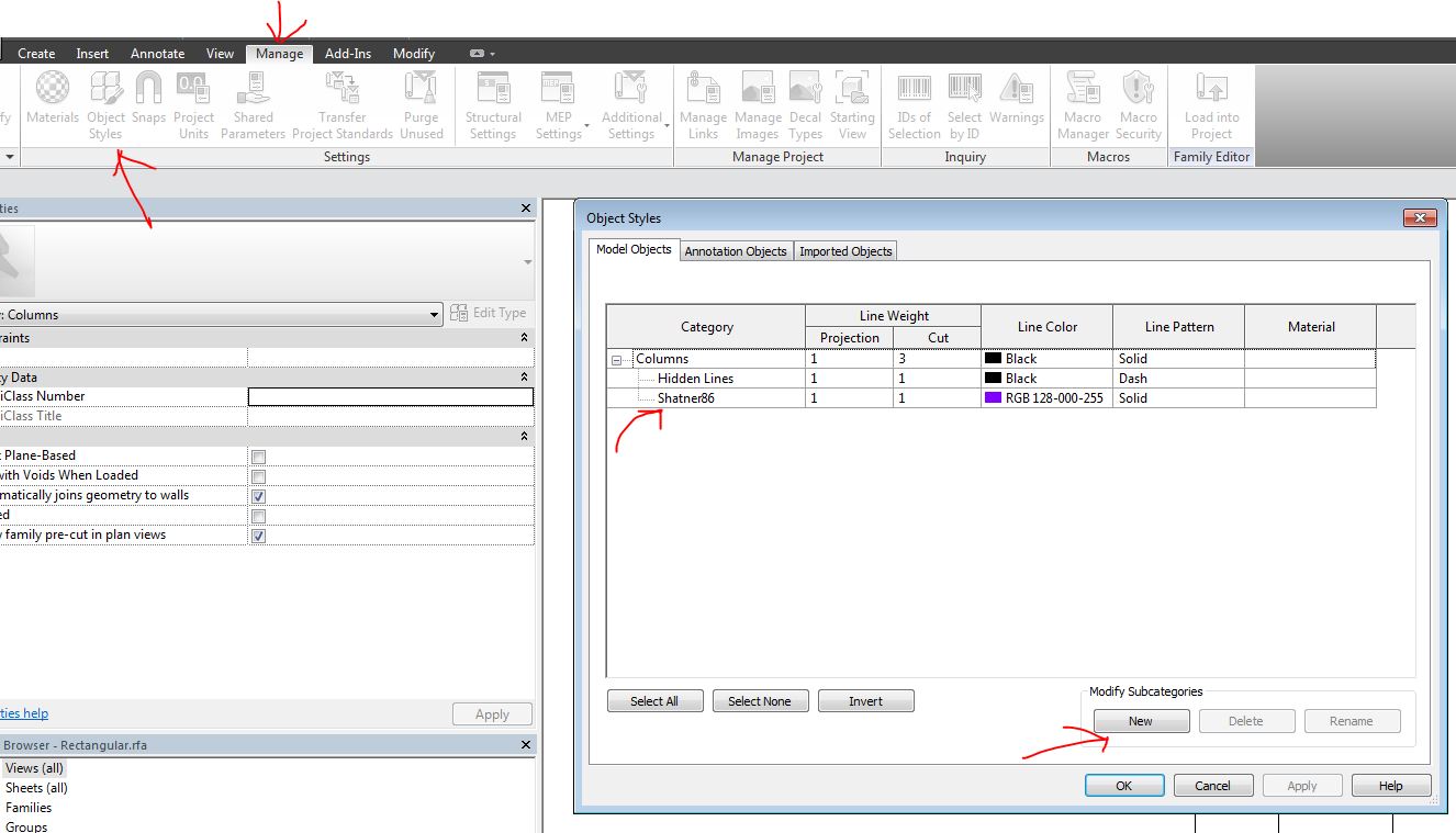

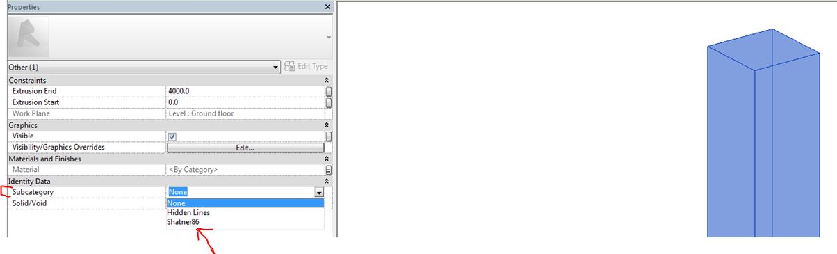

To change the line weight with Object Styles, go into the family and create an new Object Style and then select your extrusion and change the  subcategory to your desired style. See attached
Kind Regards,
Shatner86
