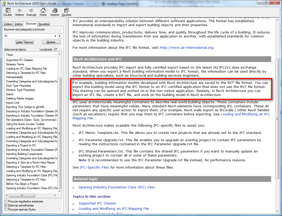

Hi DL, you can export the model to FBX to Max or IFC to other programs, see the HELP menu.
