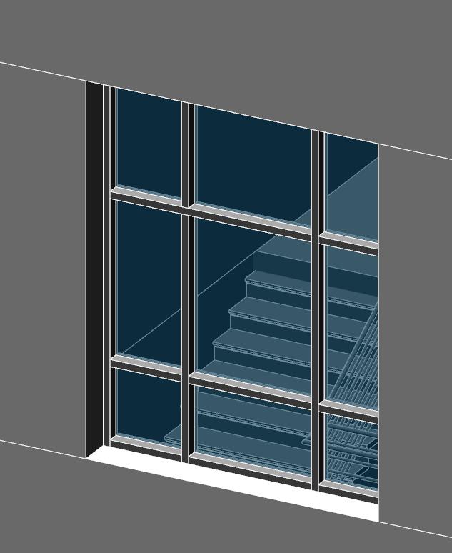

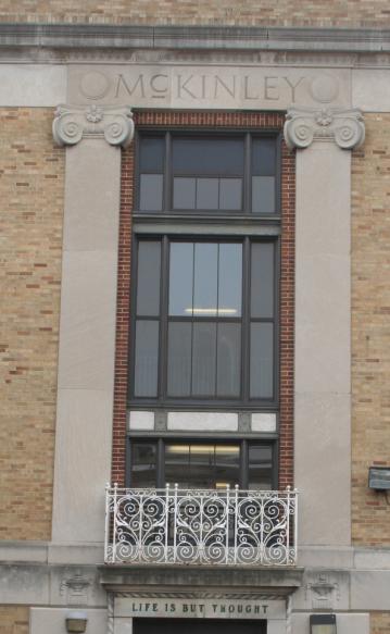

How do you make a muntin thickness in a curtain wall thicker? I also need to set the height to a specific hgt. What I am doing is making a generic window representation for a design model. I am just trying to get it to look similar.
I am using Revit 2010 MEP
In the rendering photo I am using one curtain wall to make the full hgt of this window. I want to make the 2 main muntins thicker to represent the "separations" that are larger

This smaller window in the render picture has not been stretched to the full 2 story hgt yet. May be a little misleading of what I am trying to do by showing it as is now.

Just use a different mullion....make a new type with the profile and dimensions you want.

Thanks, it was right in front of my face. I was changing the thickness horizontal instead of vertical. D'oh
