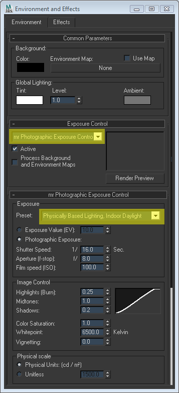

whoa! you are having some issues for sure. Are you using the photographic exposure control in your enviroments and effects? also if you are trying to speed things up, burn your final gather and global illumination to an external file. this greatly reduces render times.

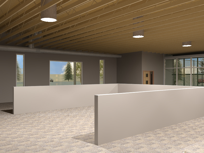

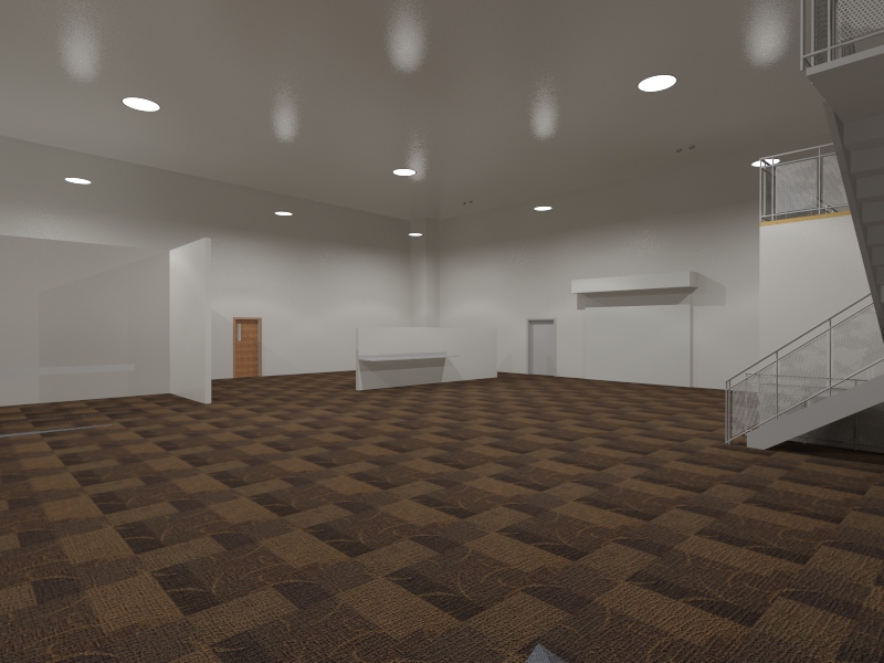

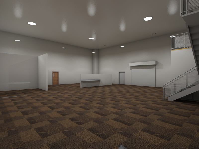

are your lights on in that scene? still looking a little under exposed. Also try exporting to PNG then you can open it in photoshop and erase the alpha channel which is the exterior mental ray sky that is blown out. look at the image i attached. here I deleted the alpha channel and replaced it with a sky jpg

Nice rendering, your carpet is coming in nicely. I still have some issues with overexposure on the carpet in my scene, but I am getting closer. I selected the sky light and cooled it off but I could not find an "exclude" option for this light. I am sure it is nested somewhere.
