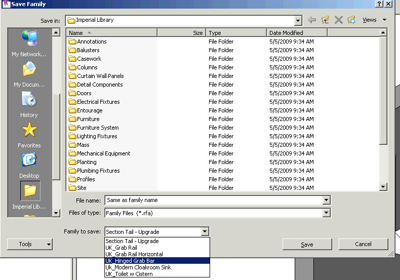

Hi guys,
I loaded a disabled toilet with baisin and handrail. they are all linked to each other.
The problem here is that I wanted to explode that family and only extract the handrail from the family. Is that possible to do in Revit? If yes, how?
Thu, Aug 6, 2009 at 8:57:02 PM | EXTRACTING COMPONENT FROM AN UN-EXPLODED FAMILY
TomDorner
Joined: Sun, Apr 25, 2004
1207 Posts
4.5 Stars: 25 Votes
You've got two options:
1.  Open the family, erase what you don't want, purge the erased objects and do a file "save as" and save as new family.
or
2.  Open the family, then do a File>Save to Library>Save Family (2009) then select family to save out.
HTH
Tom
