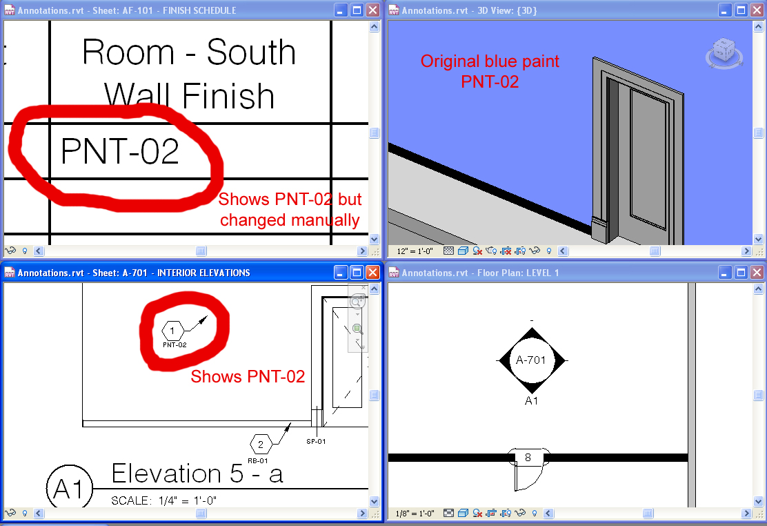

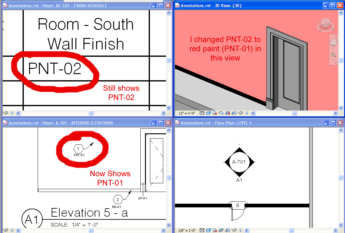

I'm trying to get our project template as efficient as possible.  My goal is to have schedules update when walls, windows, rooms, etc. are changed.  These changes could even be done in a 3D view.  For example, let's say I'm looking in a project's 3D view and realize I want the SOUTH WALL painted with PNT-01 instead of PNT-02.  If I change it in 3D my material tags update in my interior elevations but do not update in my Room Finish Schedule.
(look at the images below; PNT-01=red paint, PNT-02=blue paint)
I just want to reduce the opportunity for error.  Having to change this value twice will be a problem.  Has anyone else found a better solution?

Right now I click on the room -> element properties and change the floor finish, wall base, wall finishes (n,e,s,w) and ceiling.  All of which are project parameters I created.  Now if I change one of those parameters in any room it will not update my tags on the interior elevation.  The two aren't linked.

the images show material tags not corresponding to the room schedule.  I used the paint tool to change the material.  All I'm trying to do is have room elements (floor finish, wall base, wall finishes (n,e,s,w) and ceiling) change with the material tags.

To clear this up, the room objects know nothing about materials assigned to other objects such as walls.
The OTB finish information and any parameters you create and assign to rooms are simply "text" fields that you type the information into.  If you paint a wall, floor or ceiling with a material or assign a material to any of those objects the rooms are not aware of that information.  It would be extremely difficult to have rooms made aware of the finishes on other objects as you can have a wall going across multiple rooms with multiple finishes on the wall in multiple patterns.
If the wall has a consistant finish on it then maybe use the finish field of the room.  If there are multiple finishes on a wall then maybe fill the finish information in the room object with "Varies (see elevation).  If there are multiple finishes on a wall it is likely that you will need to indicate them in elevation to get the contractor to place them correctly.  In elevation you can tag those finishes as you have been doing.
The other option is to skip the idea of a room finish schedule all together and simply indicate finishes through tagging them in elevation.  This of course depends on the size and complexity of your project.
I tend to rcommend the 80/20 method.  Place 80% of the finish information in the room object and handle the 20% exceptions in the elevations.
Also, be sure you explore the use of "key schedules" in Revit to facilitate things like assigning common sets of finishes to a room.
