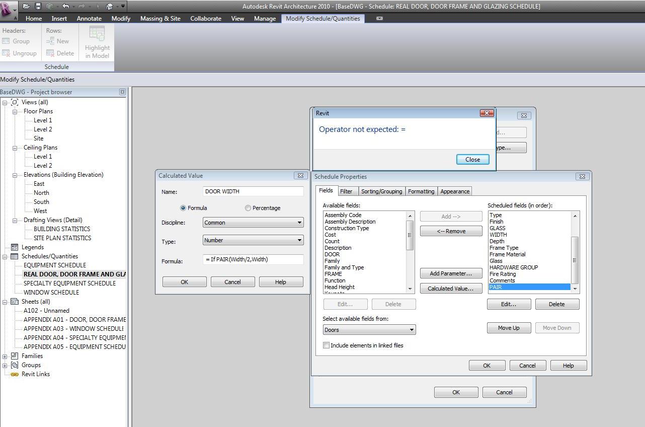

I had a question regarding the Width parameter for a double door family.
Let's say i have a double door with a width of 1830mm, how would I go about to make it so the width number that appears in the schedule is 2-915, to indicate that there is 2 doors with an individual width of 915, instead of the total width of 1830.
Any suggestions or work-arounds ?
Thanks!

However, iam not too familiar with Formulas, but iam trying it out.  Now if i get this straight, when I add a fieldtp the schedule, I click :
Add Parameter
Name it PAIR, leave the Discipline to Common, Type of Parameter Yes/No, leave it at Instance.
Now for the DOOR WIDTH, i click on Calculated Value, Set the name to DOOR WIDTH, set Formula, leave discipline to Common, and type as Number,
Now when i enter the formula that you said, it gives me an error "Operator not expected: ="
I've attached a Screenshot of what i mean.
Thanks!
Wed, Aug 5, 2009 at 10:06:03 AM | Door width for double doors appearance in Schedule
That equal was not part of the formula ... it was telling you that the field equals that.  Here is my exact formula:
if(PAIR, 0.5 * Width, Width)
Note that the Width has to be the same case as the parameter in the door family which it is.
Wed, Aug 5, 2009 at 10:25:03 AM | Door width for double doors appearance in Schedule
pimpingootch
Joined: Mon, Apr 6, 2009
5 Posts
Alright, so i've tried all that.  I made sure everything was with the same case.  However, now it's giving me the "Inconsistent Units" error.
I think it's because PAIR is a YES/NO parameter and the Width is a number paramater, so revit has trouble finding the units.
Any solution ?
Wed, Aug 5, 2009 at 10:35:16 AM | Door width for double doors appearance in Schedule
Yes - You always have to pay attention to units in Revit.   The calculated DOOR WIDTH that you are adding has to be a length parameter to match the length parameter Width that is in the family.
Wed, Aug 5, 2009 at 10:49:53 AM | Door width for double doors appearance in Schedule
pimpingootch
5 Posts
Perfect ! Everthing works !
Thanks Hub!
