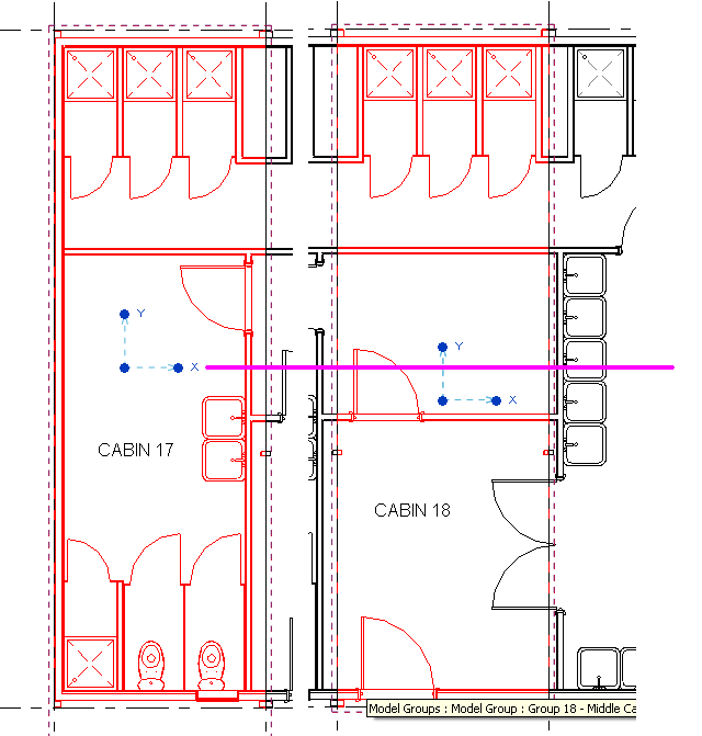

Hi,
I am trying to redefine my group origin for Cabin 18 ( See attached snapshot)
Query is
Y axis is ok but my x axis ashould be in line with Cabin 17 x axis. ( See attached snapshot. Magenta line for reference).
Is there any way?
Thanks in advance

Mon, Aug 3, 2009 at 10:49:32 AM | Group Origin
Grab it at the xy intersection button and move it

I know that but the thing is
At one time you can see origin for one group only. If i select Cabin 18 origin then no reference for Cabin 17 origin..

Draw a line such that it looks like extending x axis of cabin 17, then grab and move the origin of cabin18 and it snaps to the line.
