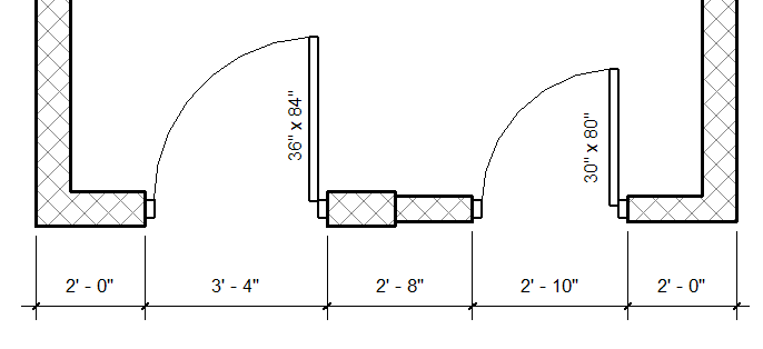

I have uploaded this family to the library however I thought I would post it here too.
This is a door family that has a built in M.O. masonry opening. So a 30'x84' door creates a 34" x 86" opening that can be dimension to as shown in the image below.
The door panel uses the material 'door material' and the frame uses 'frame material' so you can change it to 'metal' or whatever within the project.
