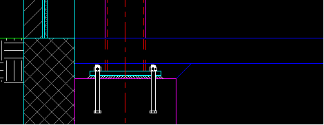

I am trying to get my slab edges to show up properly in details.  If you look at the picture you can see the blue line of the regular slab extends all the way to the masonry foundation wall.  How can I make this line end where the edge slopes?  I have tried joining geometry but that doesn't seem to be allowed.  Thanks.
I am working in Revit Struct. 2010, btw.

For most details like this, I just use edit cut profile.  If you have not learned to use this yet, please read your HELP on the subject.

FYI, Edit Cut Profile is view specific and does not modify the geometry of the entire slab. But as WWHub, it is used for these type of conditions when detailing section cuts.

got it looking correct.  thanks.

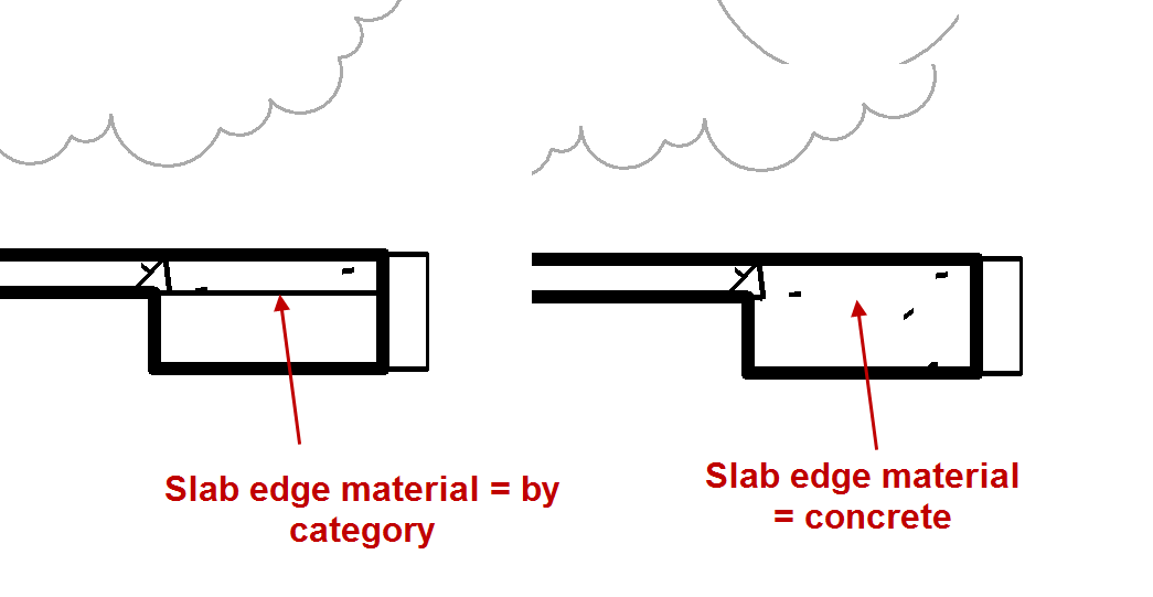

See if making the materials the same helps.
