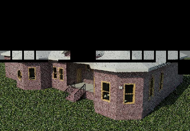

I am using Revit 09' and have had this happen a lot woth this project and I don't know what it is. I set all of my settings to custom and render a view that I had used the camera to capture. Once done, the image is not completly rendered. I have attached the image of the complete rendering. Any suggestions would be nice.
Thanks,
            Mike
Thu, Jul 16, 2009 at 7:09:35 AM | Rendering done but incomplete?
Joined: Tue, May 22, 2007
5921 Posts
4 Stars: 205 Votes
Try to delete that camera view and create a new one, render and see if the problem is solved...
