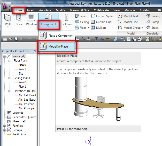

"In the Family Editor, on the Create Forms panel, do one of the following.
  • Click Solid Sweep"
well, when I go in the family editor and click on the Forms panel, I don't have the option for Solid (or void for that matter) sweep.  I don't know why I don't have those options and nothing in the program seems to want to tell me why either." - The "Create-in-place"in 2010 is in "Home>Component">Model-in-place"
