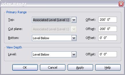

Just create a plan of the uppermost level and set the cut-plane at 500' (or still higher?).

The attached image shows the defaul view range for the site. (View Properties > View Range)
Also not a bad idea to apply the site view template as well. (Also in the V.P.)
