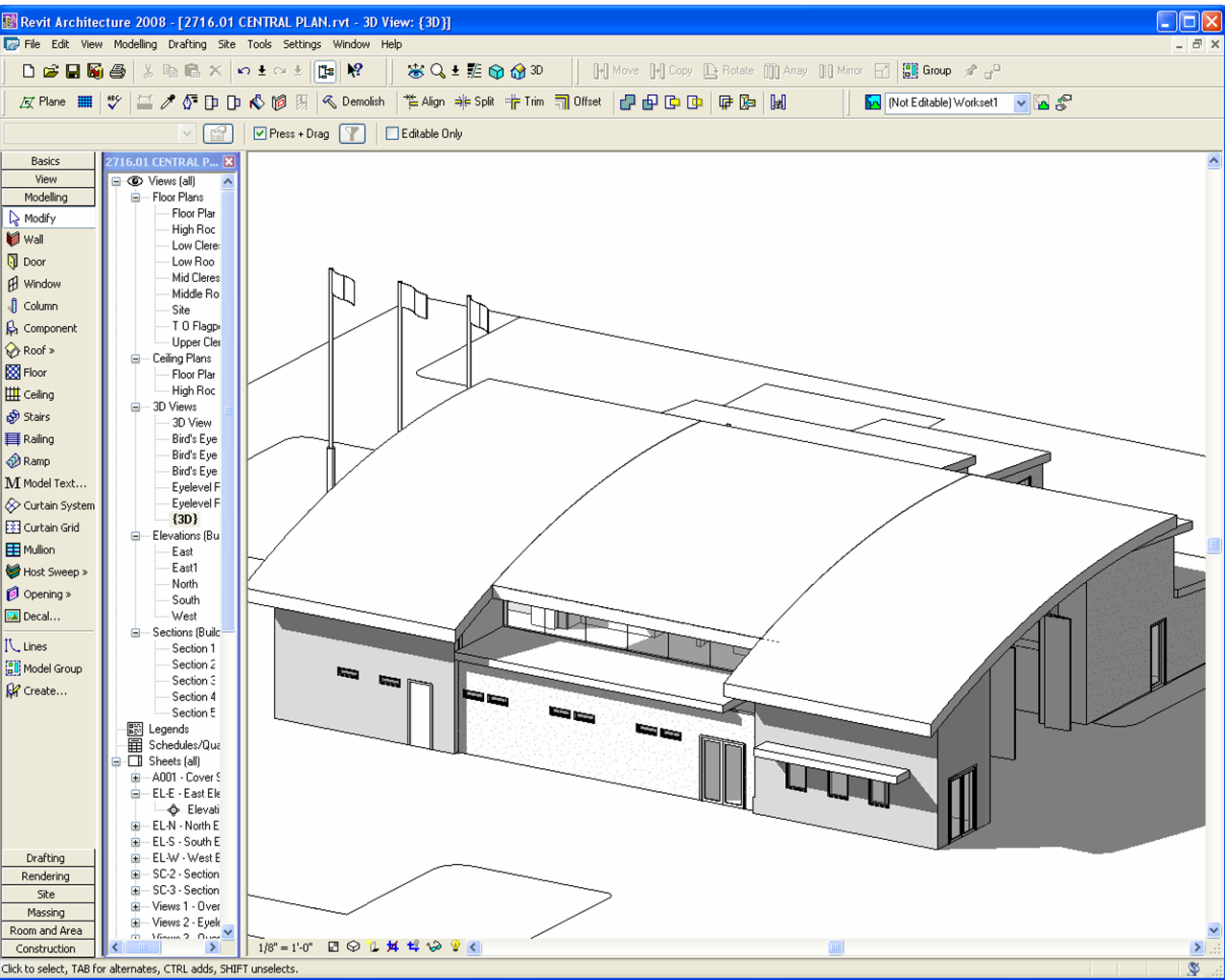

So how about mass and void in a roof?  I've got a curved-profile roof, but there's a portion that extends out farther on the ends than it does in the middle (see screenshot); must I make more than one roof surface to satisfy this requirement, or can I make it one, lovely, sweeping curve that happens to have a notch in it?
Thanks, -r
