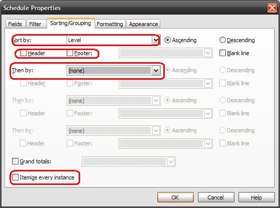

Max,
Looks like you have 'Itemized every instance' in schedule property.
See attached image. It shows how you should sort the schedule. Once you format it that way, you'll get only 1 row per level. You can then easily click on the rows one-by-one to select elements by level.
Feel free to ask further, glad to help.
