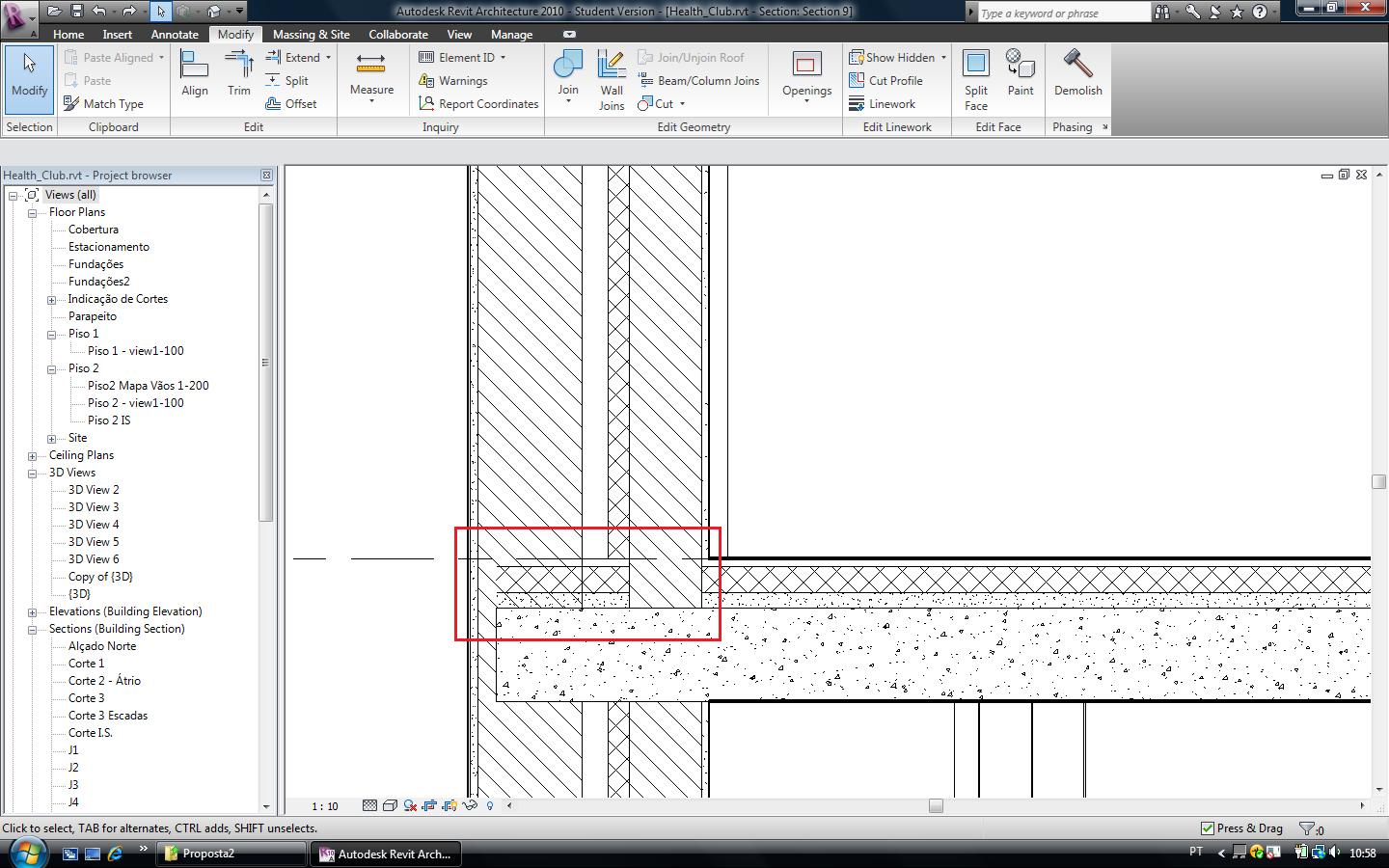

Hi,
Im having some trouble joining a double exterior wall with the floor, the structural joint is ok, but then the layers of the floor apear over the outsitde wall, instead of stopping on the face of the interior wall as they do. How can I change this?
Thank u, Zé
Thu, Jul 2, 2009 at 6:23:38 AM | Join wall/floor
Joined: Tue, May 22, 2007
5921 Posts
4 Stars: 205 Votes
You must check the "Core" of the slab AND the Wall...
Thu, Jul 2, 2009 at 7:07:41 AM | Join wall/floor
If you want more of an explanation of what Typhoon is talking about, serach your HELP using "cleanup" and read the topics there.
