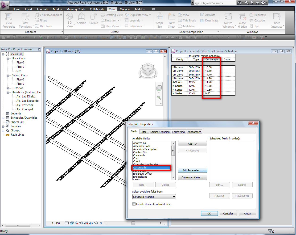

I really, really need to know how to get the Cut Length of a beam to a schedule.Is there any way I can do this? (Cut length is'nt a normal parameter in the family so I cant make it shared there..)(I work in Revit 2010)

I don't know what is the problem, create a "Structural Framing Schedule" and add the "Cut Length" parameter...

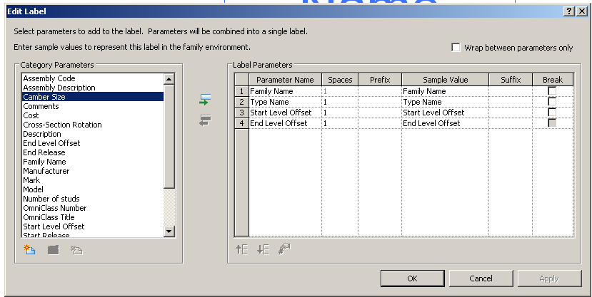

Hm.. well. Accually I was going to do a lable. But it must be the same parameters there?
I dont have it..

But, do you want a SCHEDULE or a LABEL?

label. sorry, I mixed them..
