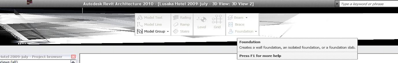

I am getting a constant crash on one of my PC The Ribbon Interface starts to change into funny looking images and looks much like graphic problem:

See also attached Image of Ribbon
