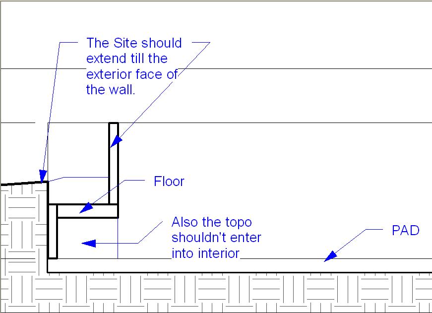

Please see the attached image and can any one has an idea or solution for this kind of requirement. My topo shouldn't enter the building but should toucht he exterior face of the wall at the top.

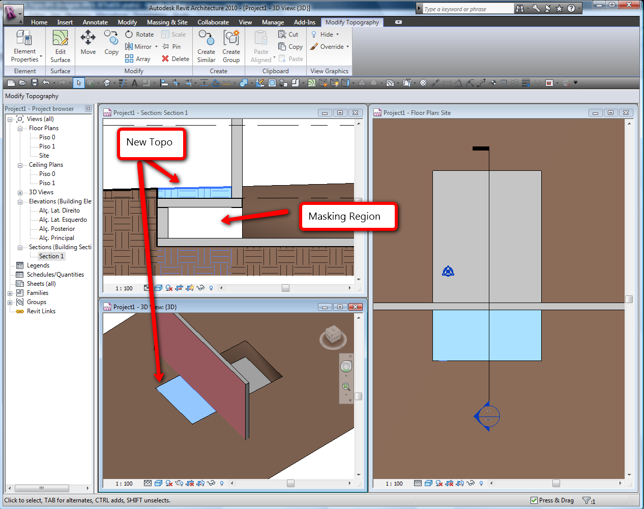

The situation is right, the Pad Cut the topo Vertically, what you can do is create an "extra" topo surface in top of that and create a masking region like i put in the image attached...

Hey Typhoon I already did that with masking...but I just want to know if there are any other options...anyways thanks for the reply.

Well, if you don't want this method, just create a slab and adjust the elevation point in the corners of the slab but you must create a "Filled Region" because the pattern of the earth between the 2 slabs....
