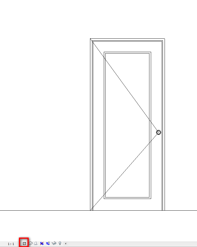

I want to see the door handles in my views but I don´t, I am not sure if it is because the family doesn´t have handles or because I have to click some show button, any help?
thanks!
Sat, Jun 27, 2009 at 11:58:51 AM | can´t see the door handles!
erland73
erland73 Avatar
Joined: Fri, Sep 7, 2007
738 Posts
4.5 Stars: 85 Votes
In your View Control Bar, pick Detail Level: Fine. Saludos hasta España y bienvenido a Revitcity......

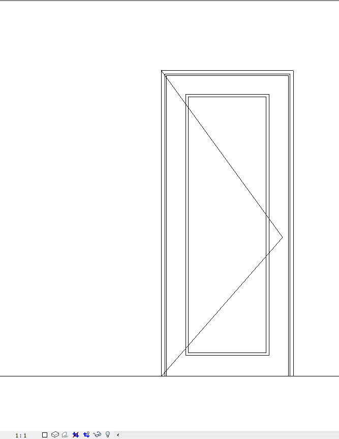

I stil don´t see it, does it mean that the family that I´m using comes with no handles?? it is the M_single_flush
I want to show it in the rendering
thank you so much!
Sat, Jun 27, 2009 at 12:06:59 PM | can´t see the door handles!
erland73
erland73 Avatar
738 Posts
4.5 Stars: 85 Votes
Por lo general esas puertas vienen sin el pomo (chapa)...pero puedes buscar en la sección de downloads....
