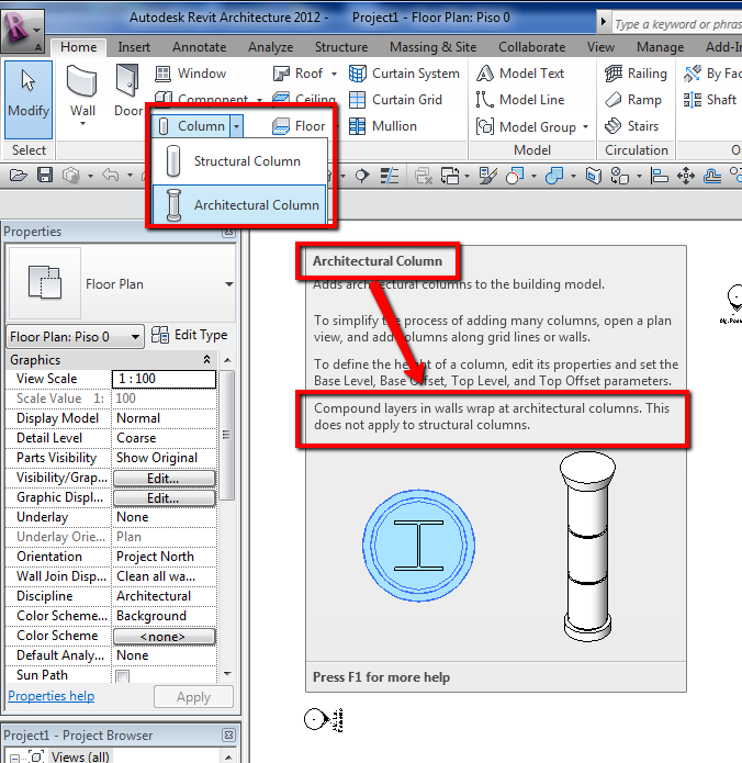

further ectension to your question, i want the material of the adjacent walls to cover the columns, any idea?

There are two types of columns, "Structural and Architectural Columns", maybe this is what you need.
