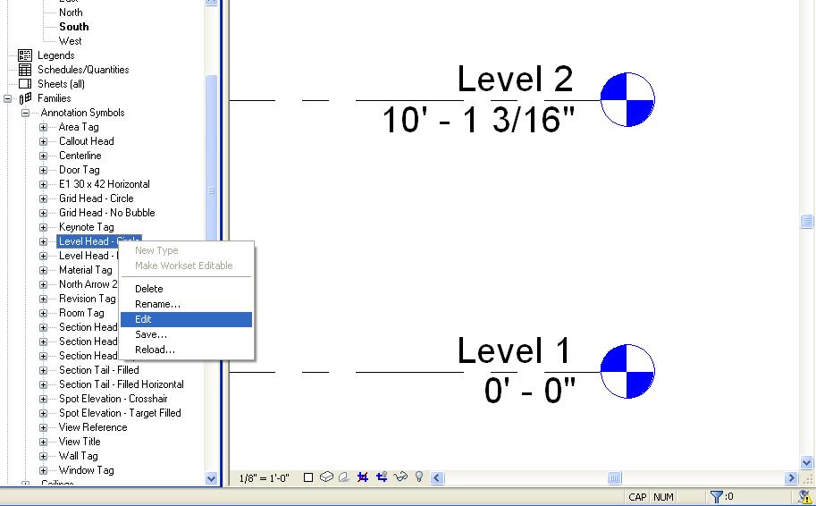

I have a level with an elevation that reads 14' - 1 3/16", but the actually elevation is 14' - 53/256" so there is some rounding going on. My question is where can I control this. I am hoping to get it to read 14' - 1 1/4". I don't want to move the level, I just want to control the tolerance of the rounding. Any help would be greatly appreciated.

Click on edit as shown in the Attachment 1.

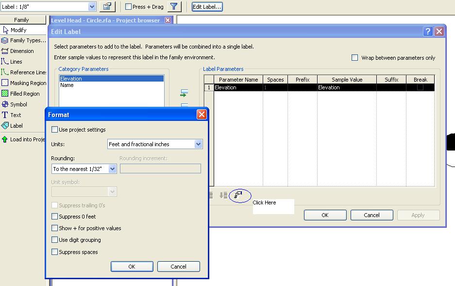

Then select the Elevation label and click on  Edit Label as shown in Attachment 2.

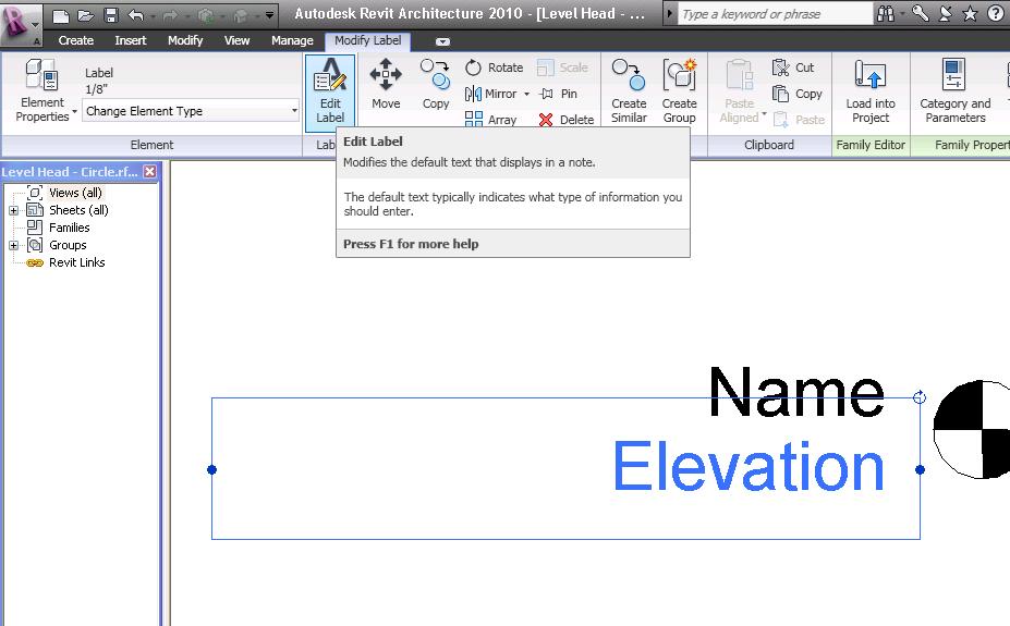

 Then follow as shown in Attachment 3 and change the rounding to 1/4".
Load to the project. Done.

What Pavan posted did work...it turns out I wasn't doing it properly before. Thanks Pavan

In 2009 you would adjust the tolerance in the "project units" found in the "settings" menu.
