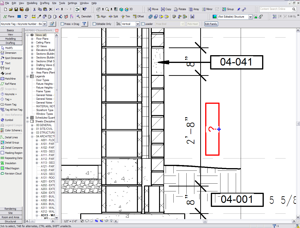

I am trying to use the Material Keynote tag in a dimension string to show the length of a certain color a brick. The color of brick is built into the wall. The problem is when you use the material keynote tag it MUST have a leader attached or you get a question mark in the box. See attached image. You can use a User keytag but that eliminates the parametric quality of the keytag. You can use the Element keytag but that will tag the entire wall essembly. Essentially I need an invisble leader for the Material Keynote. Is this possible or does anyone have a workaround? Thanks in advance. -Tim
