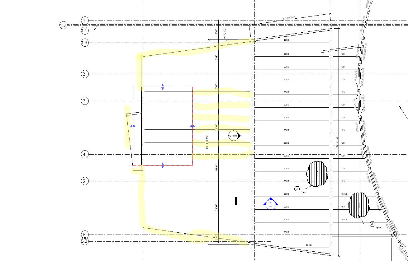

So I wanted to use a plan region for the 1st time, but it isn't working correctly for me.  I'm using RS2009.

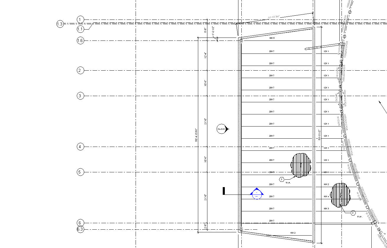

 I am at a 3rd floor plan, and created a small plan region to display part of a lower roof area.  But when I do, the walls, roof joists, and roof deck which are shown inside the region are also shown outside the region boundaries.  I can not understand why this would happen.  Shouldn't anything that is outside the region boundary just be cut off, and the display would revert back to the view range of the host view?
I have attached two sketches, one before adding a plan region, and one after, so that you can see what i mean.  I highlighted the elements which are displayed beyfond the plan region but should not be.  Any help is much appreciated.

Unfortunately I have found that whenever a plan region boundary comes in contact with any type of component it will be displayed according to the plan region view range (yes the entire component).  It sounds as if you may need to do a combination of a plan region and a split crop region.
