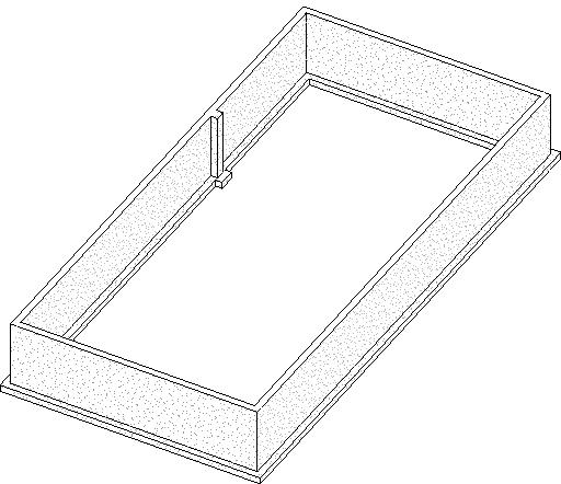

I am finding that doing Pier details is really tedius.  You have to manipulate the size of the pier (which we have as a family), but we form the pier usually against the foundation wall, so when I center the footer to the column, I have to hide my pier because it is not the same size as our formed pier.  Then I have to mess with the linework tool to change the footer and mudfooting to a hidden linetype, the peir and wall to a heavy lineweight, and sometimes create an in-place mass to make the pier the size I need.  Oh yean, I figured out how to join the objects so that the pier actually is formed as part of the wall and not separate.  And then there is the fun chore of dimensioning and annotating the Pier and placement of the anchor bolts.

In specific for piers and footings. You want to spend time making families and types you can place in the model. Place the correct pier next to the wall and join to the wall. Place the correct footing for the pier and join to the wall footing.

You all had very encouraging things to say and I appreciate the feedback.  We have some in-house families for piers and footers, but we made them both as one parametric family.  From what I am seeing, I am wondering if it should be two separate families.  I never thought to attach the piers to the walls either, I think I was fortunate this time that it did it on it's own.  The one thing I have noticed is that the piers were created to be center of the footer.  However, when we do an addition to an existing building, our footers will be formed right next to the existing foundation wall, and so our piers will be centered with the columns above; but the footer won't be.  For this reason alone, should the two be separate families?  What I have done so far is just use the linework tool to hide the pier, and then just drew in where the pier should be and it's size using detail lines.  But as I have said, I never thought to attach it to anything.

You should not hide your pier. The key to Revit is to have the model work for you. I went back and played with structural walls and columns and they do join by themselves. In the image I poste I used a OOTB Structural Concrete Column that I rotated and aligned with the foundation wall with an isolated footing. I duplicated the OOTB footing and made one the size i wanted and placed it under the pier. I think it just a matter of creating the proper size pier and footing.
Post a couple of screen shots (plan and section) of what you're working on and we can be more specific with best way to create.

I understand what you are suggesting.  After discussing it with my Drafting Supervisor yesterday, we agreed that we should  use footers for the parameters that we can schedule.  I have found that the piers I have made do not clean up with the wall (in plan view) if I try to use 'Join Geometry' on them.  The foundation wall line is still seen beside the pier, which, when formed is one form with the wall.  It does not move with the wall either.  I have found that using an 'In-Place Model' works well for this.  It breaks the wall in plan view and moves with the wall as well.
I may not be doing something right, but this is what has worked for me.
