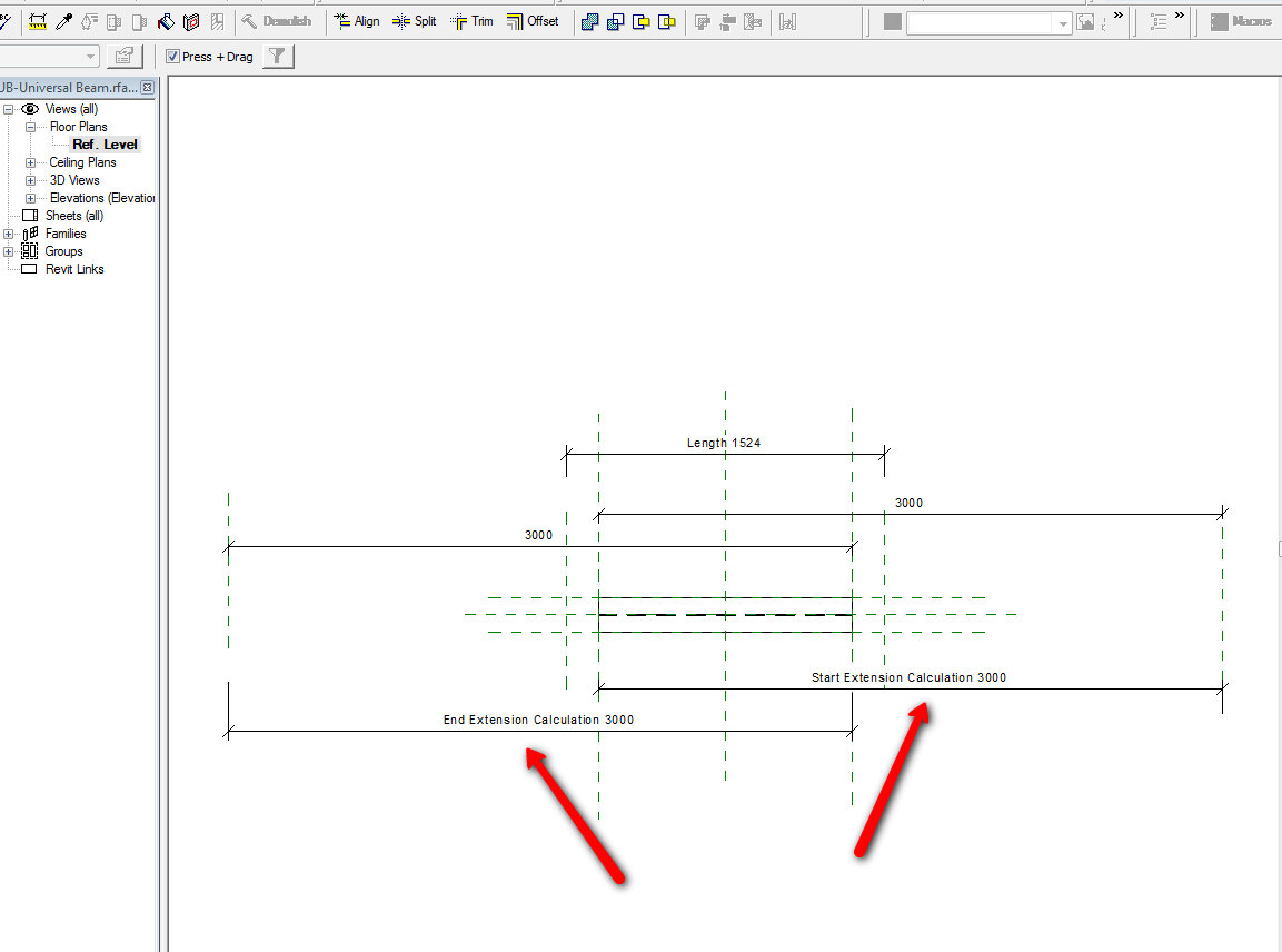

I’m still working with beams and I have a new problem..
There use to be a hidden 12.5 mm parameter somewhere and  then there use to be Start Extension and End Extension of 2.0 but on my beam these parameters are missing. How can I get them?
/Sanne

Check editing the family to see if the family has those parameters...

It dosn't have those parameters..

Well, create in the family those dimensions then go to add parameter and create them like you can see in the image i post before, i hope the beam is attached to ref. planes if not use the "align" tool to do that...

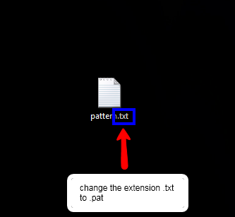

I want to create a file with extension .pat but I d'ont know how to do it. Please help me. Thank you.

Quoting Hanh from 2009-07-18 22:36:49
"I want to create a file with extension .pat but I d'ont know how to do it. Please help me. Thank you."
To create it, just change the extension of your .txt file (you are creating a fill pattern with Notepad, right?), to .pat (you have to uncheck "hide extensions for known file types" in your Folder Options....
