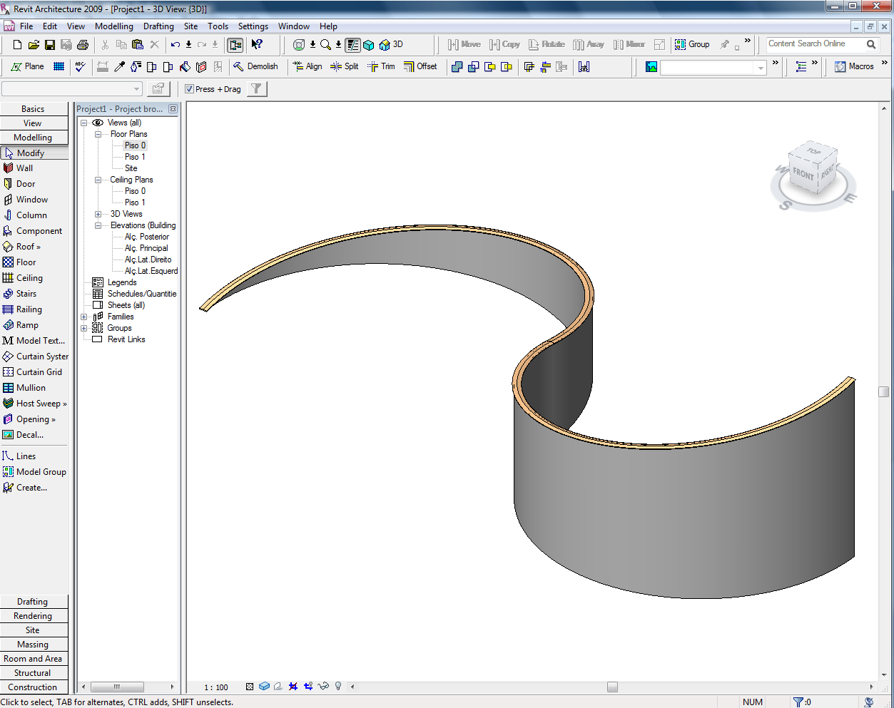

"Revit 9.  Can't open your file either." - Well, this video i create in 2009, i don't get it, I can download the video and see, this is not a model....

That was great.  Thanks for the video.  However, I would like the 2D path to be more complex.  Sort of like an 'S'.  And the top of the wall has to have a vertical bump.  Sort of like a bell curve.  Should that be several blends instead on one joined together?

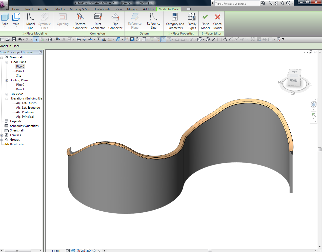

More complex like curves shapes in elevation only in 2010....

Thats EXACTLY what I was trying to do.  How did you do that?  Were you able to create the 2d path with more than one segment?  I tried the spline feature and i could not use more than 2 nodes.

Which one??? the first or the last image?? the first was in 2009, the last one was in 2010...

THe last image.  Revit 9.  I don't have Revit 10 loaded yet.  Can you do that in Revit 9?

NO, because the "curved shaped" in elevation.... only allow straight segments and it's not in Solid Swept blend but Solid Sweep....
