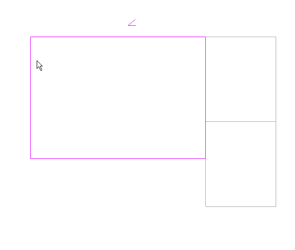

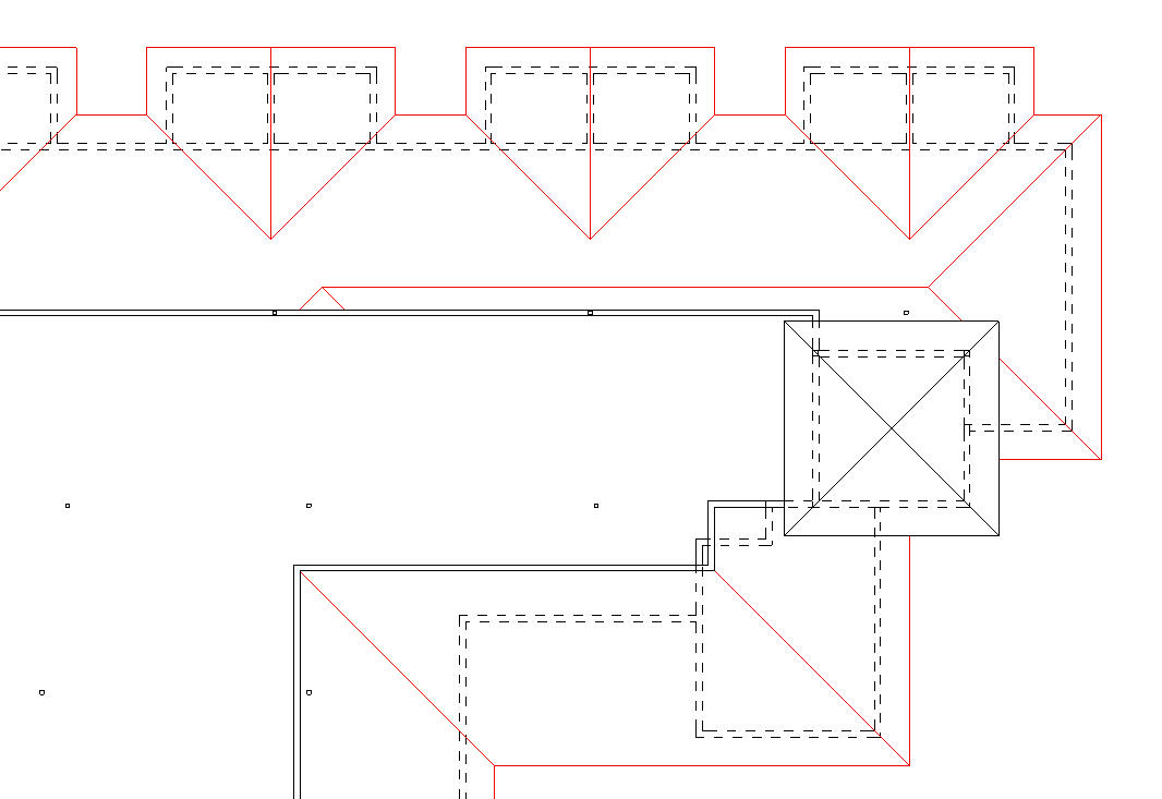

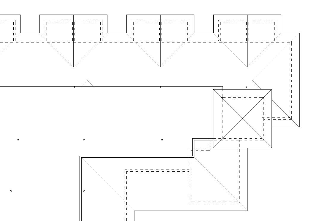

My roof lines don't work like how they should. There should be a hip coming off the parapet but instead it wants to run the ridge back to far and then I end up with a cricket that isn't needed. I have tried playing with the different roof lines in numerous ways but yet to find the solution. Anybody have any thoughts?
Tue, Jun 16, 2009 at 8:13:36 AM | roof lines don't work

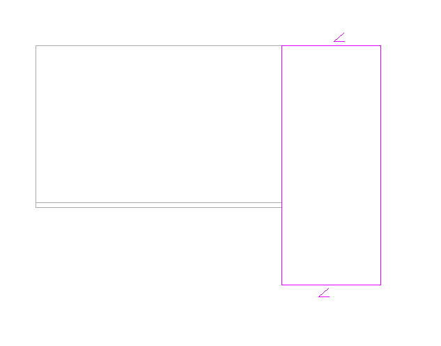

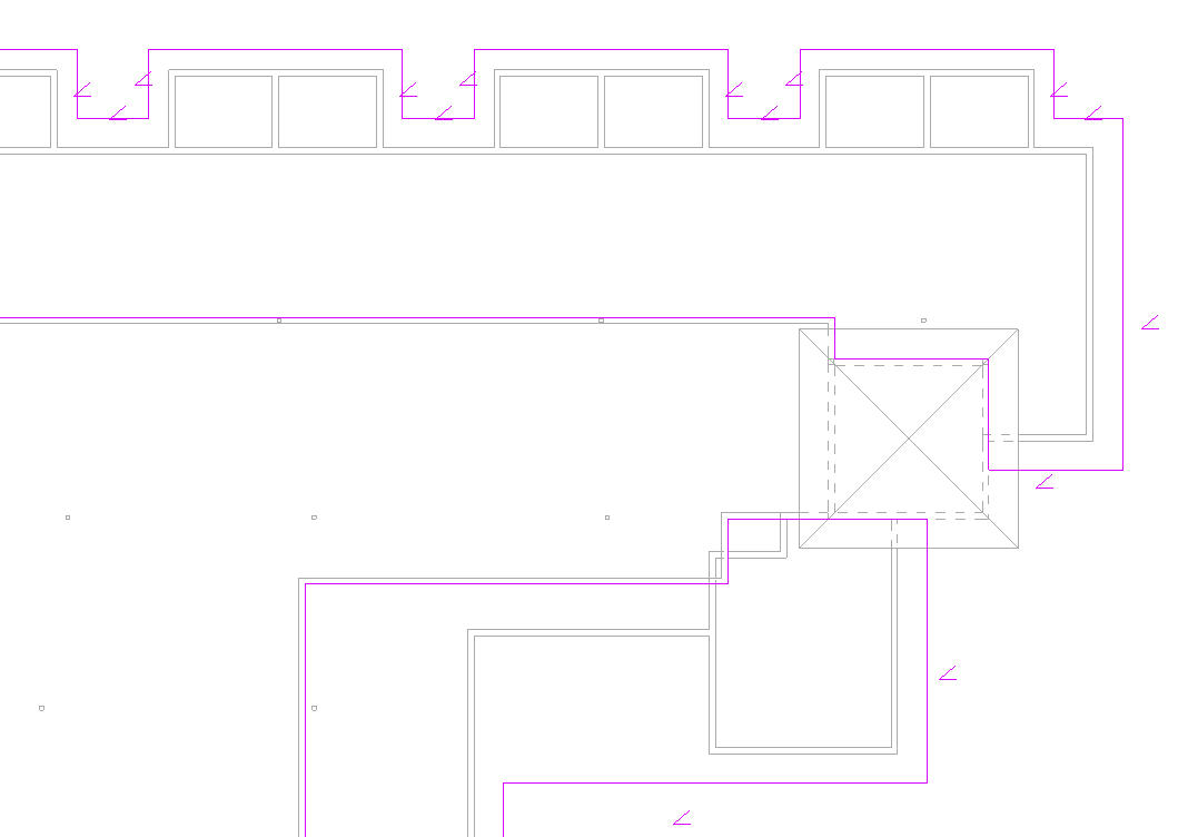

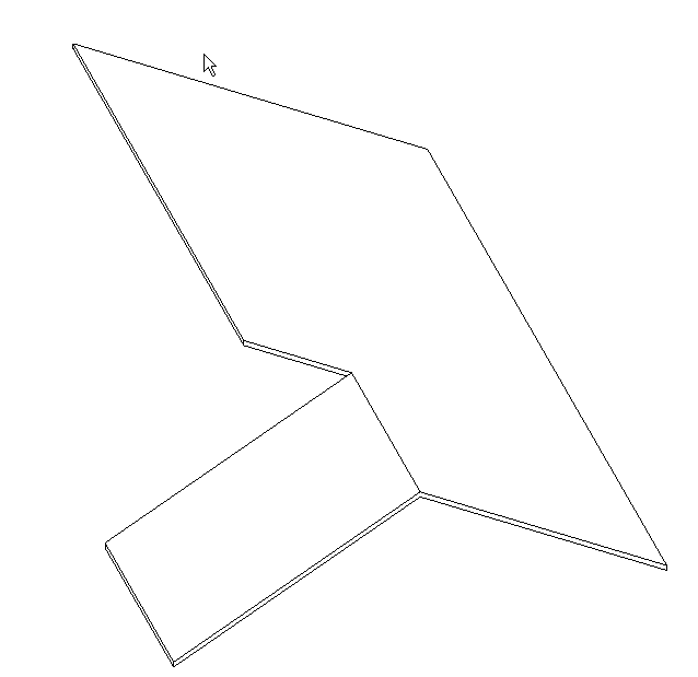

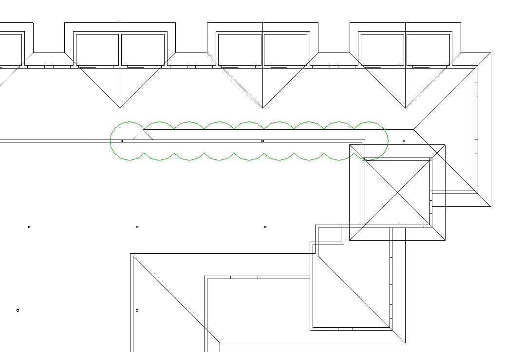

Make as 2 roofs and join geometry.
61206_ScreenHunter01_Jun._16_09.10.gif61206_ScreenHunter02_Jun._16_09.10.gif61206_ScreenHunter03_Jun._16_09.11.gif

I cut back the roof and scabbed on another piece like you said. It took a bit to make it work but it finally worked after figuring out the lines to make the second piece.
Thanks!!!
