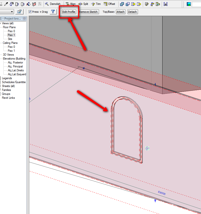

Simple, pick in that curtain wall then in the options bar pick in "Edit Profile", create lines inside of the curtain wall, that create the openings....

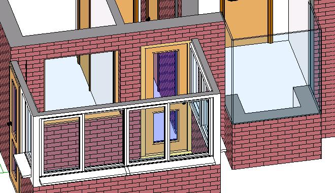

I have attached an image if it will help. I am basically trying to fit a window sill underneath the curtain wall as you wouls see underneath normal windows. On the image here, if you look to the left you will see some normal windows that I have placed and they have sills at the bottom. To the right of those windows on the next bay along, I have placed the curtain wall we were refering to. It is at the bottom of that curtain wall where it rests on the brickwork that I want a sill added. I am not sure how to achieve this.
Hope this image helps a little.

Ohhh, i was think in other thing, well it's simple, you can do that in several ways but now the faster is create in place with solid sweep the profile you want (on top of the wall) and give it a material you want..., do you get it???
