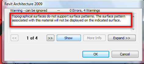

I've a big problem: when i go in 3D and make a section I can see the earth pattern but whet I go in one floor level I can't see it.
How can I activate this view?

Because you are trying to see the earth pattern in a surface apply to a toposurface.....
