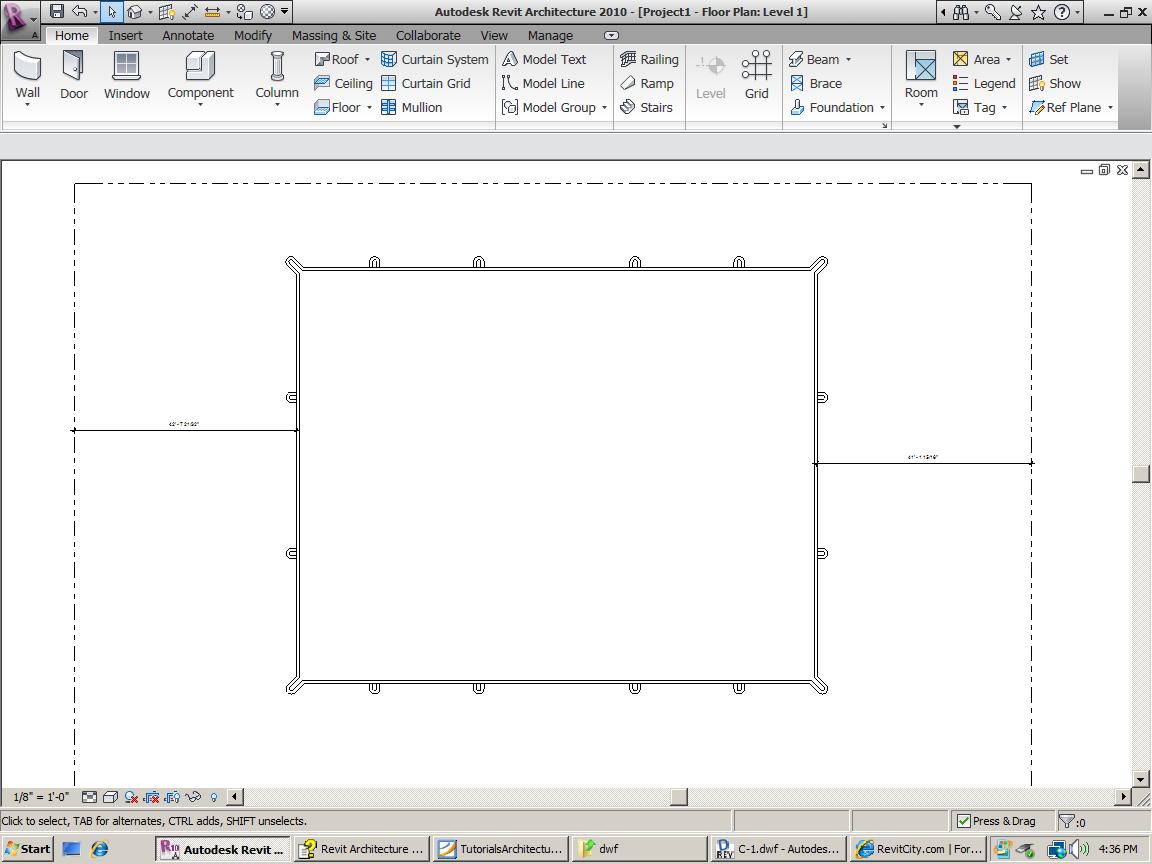

see screen shot..
i can highlight the building and move it with the arrow
keys but i can't get the same distance on both sides
to the property line..
tried to equalize the dimensions but everything other
than the whole building moves.. ?????????

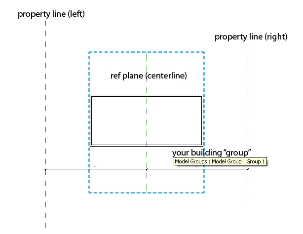

Draw a reference plane at the "centerline" of your building (parallel to the property lines). Now, select the reference plane and EVERYTHING on your building (pull a selection box around it all) and group them together. Now pull a running dimension from the left property line, to the centerline reference plane, to the right property line. Click the EQ button that is presented after placing the dimension. This will center the building. Now, simply "ungroup" the group you made. And, presto! Your building is centered...
Edited on: Wed, Jun 10, 2009 at 9:54:03 AM
Wed, Jun 10, 2009 at 9:59:08 AM | Center the Building
This is a case of which is easier to move - the building or the site?  If you have a lot of detail elements/tags/dimensions done on the building, you don't want to move it.  Move the PL's and the site....
